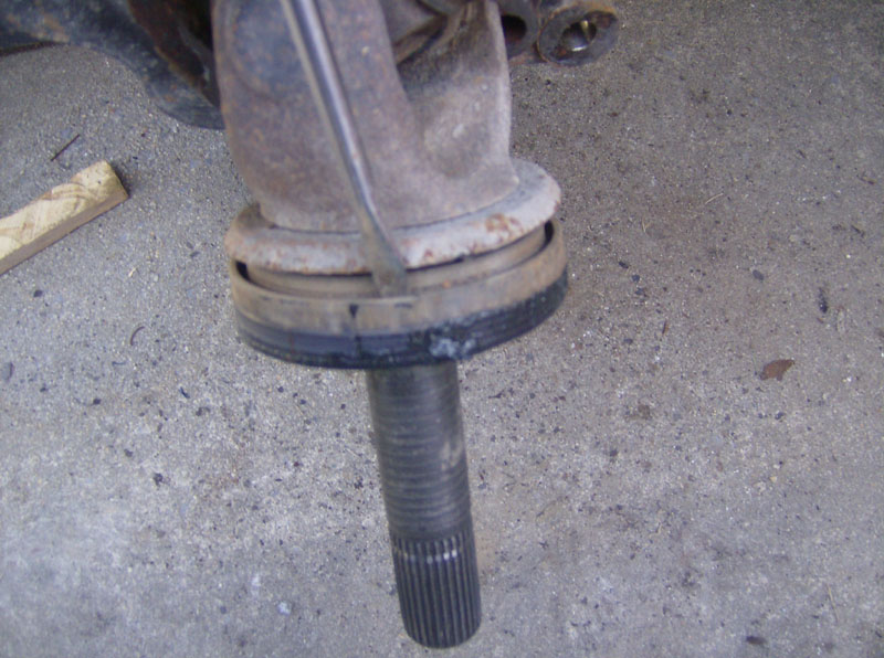

The old seal came off quite easily on both of my axles. I just left the stub hanging down (with the long part of the axle still in the axle tube) and used a screwdriver & hammer to knock them off. Wasn't much trouble for some reason.
The old ones came off MUCH easier than the new ones went on. You should expect to whack on that seal driver pretty hard to get them on there.
Here's a not-so-good pic of what I'm talking about above....

What I mean is you need to get between the seal and the axle and pound on the metal part of the seal. See this photo.
http://www.clubfte.com/users/racergu...of100_0033.JPG
EDIT: Jason beat me to it. I took my out and did the same thing with the axle in a vice but like Jason's photo and the one I posted would work as well.
