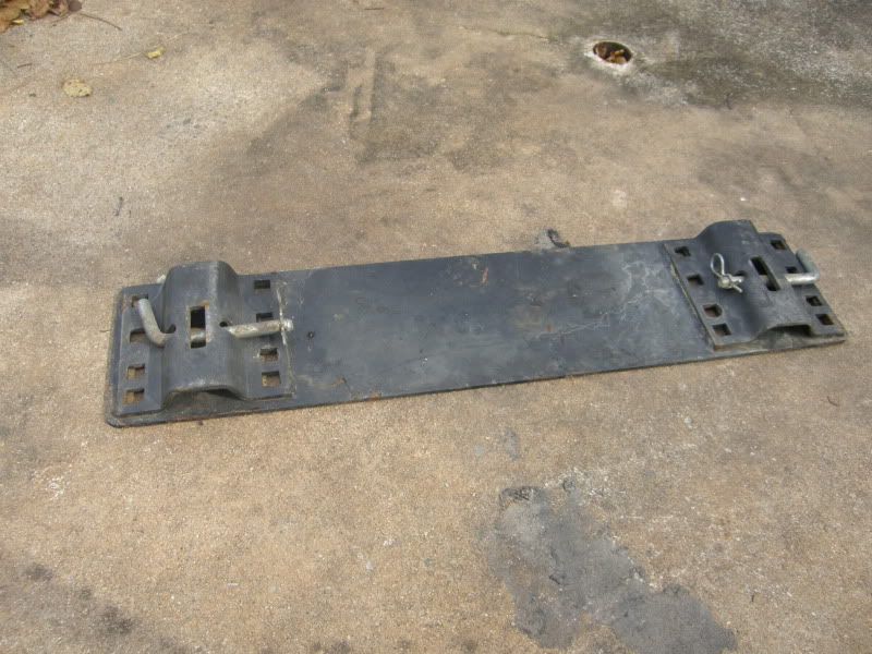

Hi, I bought this Putnam fifth wheel hitch(I now know that they are no longer in business), but I still need to install this thing and use it. I am kind of unclear on the installation.
This is the hitch. Base number is 15093.
This is the bracket.
This is the bracket on the hitch.

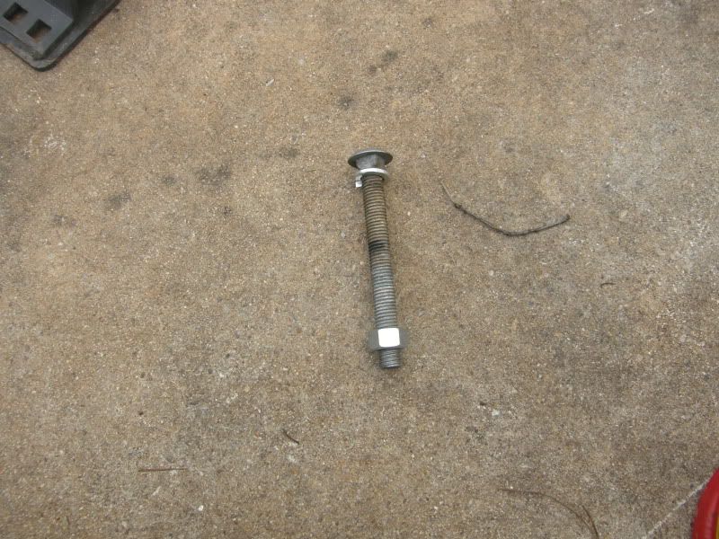

This is the bolts that came with it.
And this is the bed of the truck.
I may have to remove the goosneck that you see in the bed of the truck, but would rather not, because of the hole that it will leave.
My main question is when I lay the mounts in the bed, the guy I got it from said to just drill the hole through the bed and the frame and slide the bolts through and tighten them up. What about the corrugation of the bed? Shouldn't the mounts be able to lay flat against something? Any help would be appreciated.

I looked at the goosneck converters for my fiver, but actually wanted both. The hitch will mount over the goosneck ball and then I can remove the hitch if I ever need the goosneck ball. With the hitch, I can pull different fivers or goosnecks.
The only question that I have about the hitch is if it is ok for the rails to sit on the corrugation of the bed and will I need spacers under the bed between the bottom of the bed and the frame rail.

Just my $0.02. The mounting plates should lay on the bare metal. Don't put any rubber sheeting between the mount plates and the bed. Mount the hitch over the rear axle, better yet it should be just a tad forward of the rear axle for weight distribution.

Installation is pretty straightforward, I'd just snap a chalk line along the bed mounting bolts, mount the plates on the hitch, set your center 3-4" in front of the axle, and punch mark the hole in the plate that's closest to the chalk line. Pull the whole thing back out, drill the punch marked holes through the bed and frame, bolt the plates in and mount the hitch.

Ok, thanks for all the responses. I have set the hitch in the back of the bed with the mounting plates attached to it and it looks like the back bolt is actually the bed mounting bolt itself. This will set the hitch about 3-6 inches in front of the axle. I'll bolt those 2 in and then the front will line themselves up. I really appreciate all the help. Thanks.

If there is a gap between your bed and frame where the 5er hitch bolts up you may want to make some steel bushings so your pin weight sits on the frame and not the bed.

Yea, I think that would be a good idea. I will drill my holes and where they line up I will measure between the bottom of the bed to the frame and make sure I have some steal spacers for that area. Thanks.
