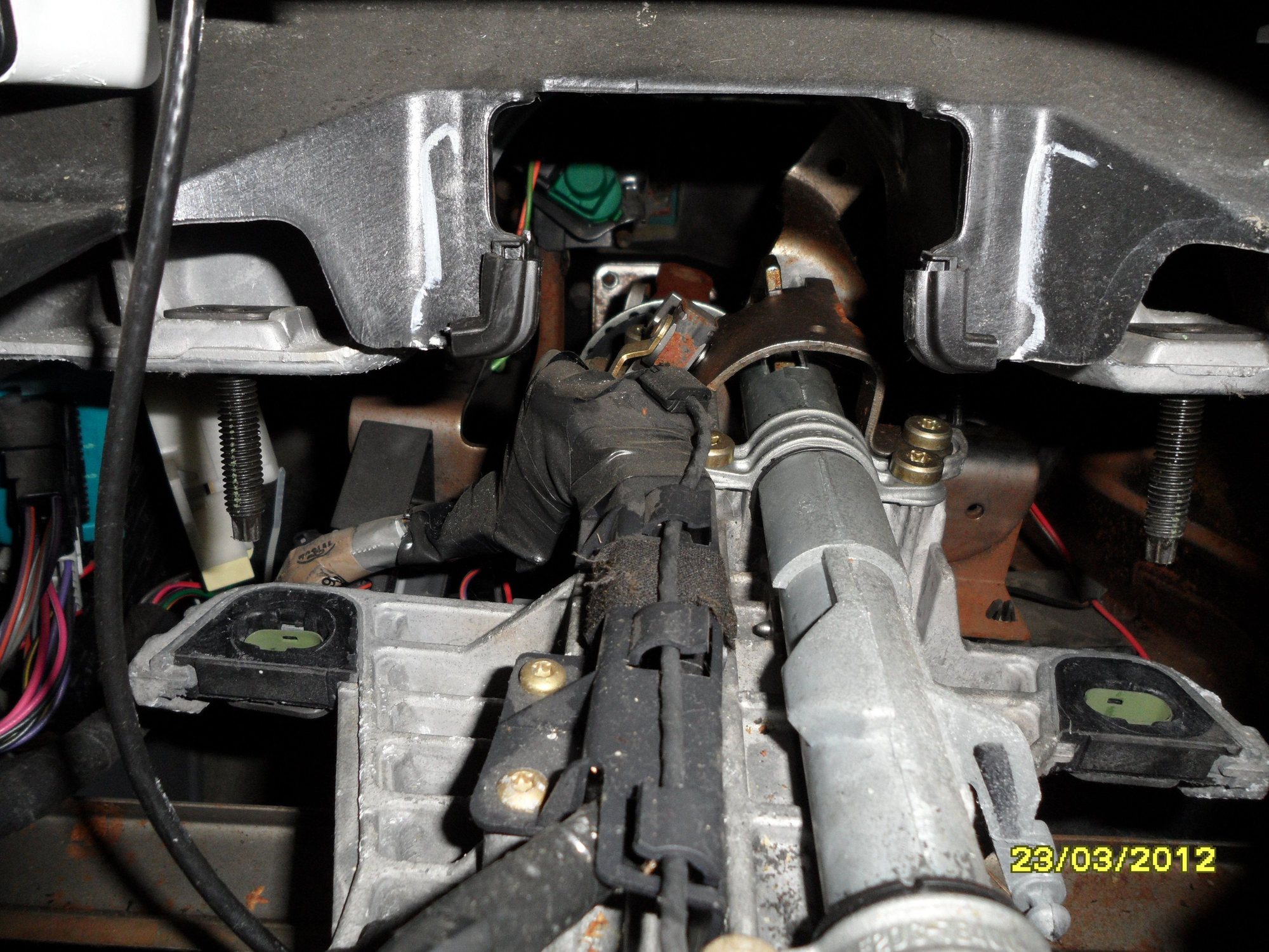

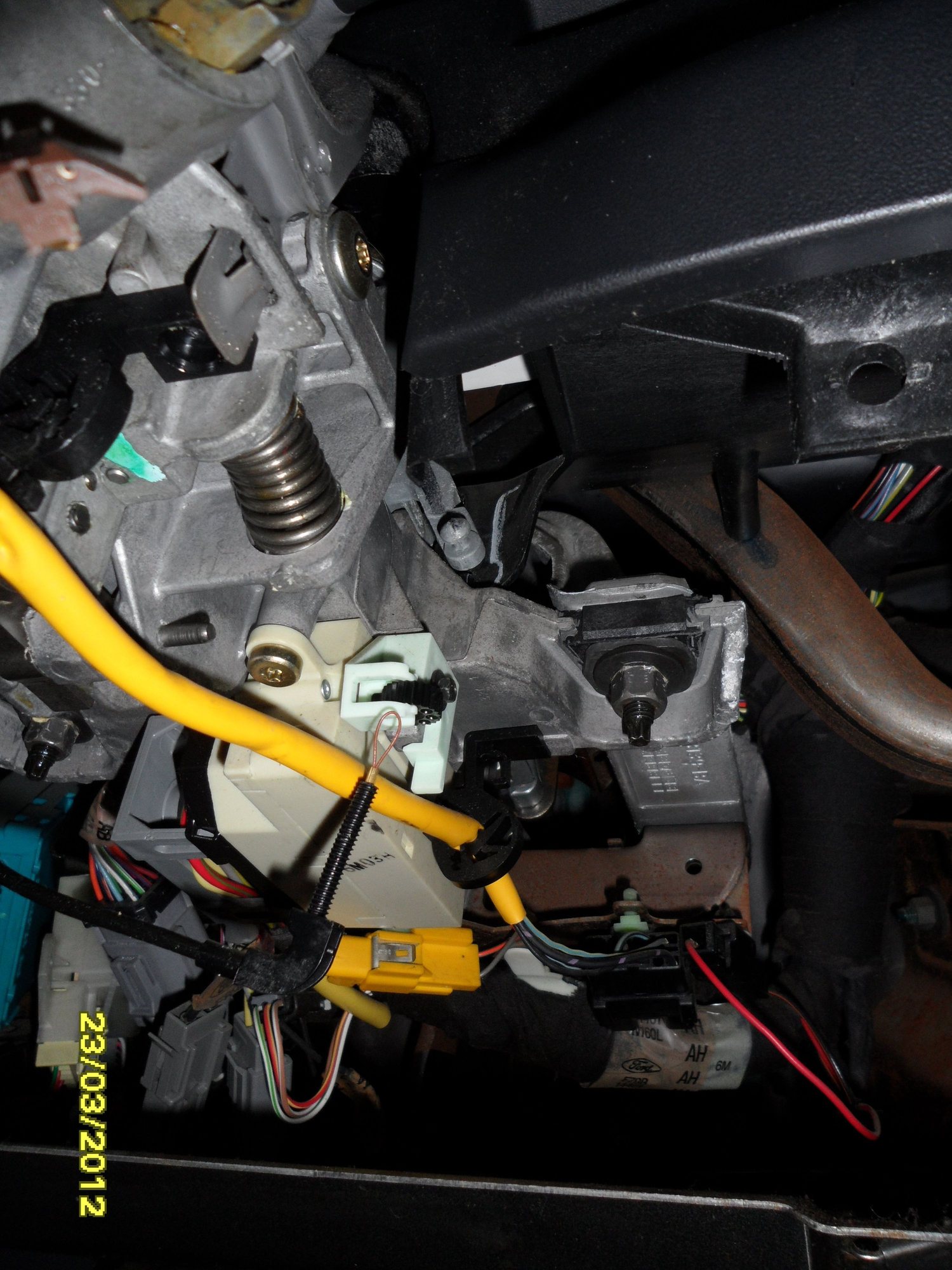

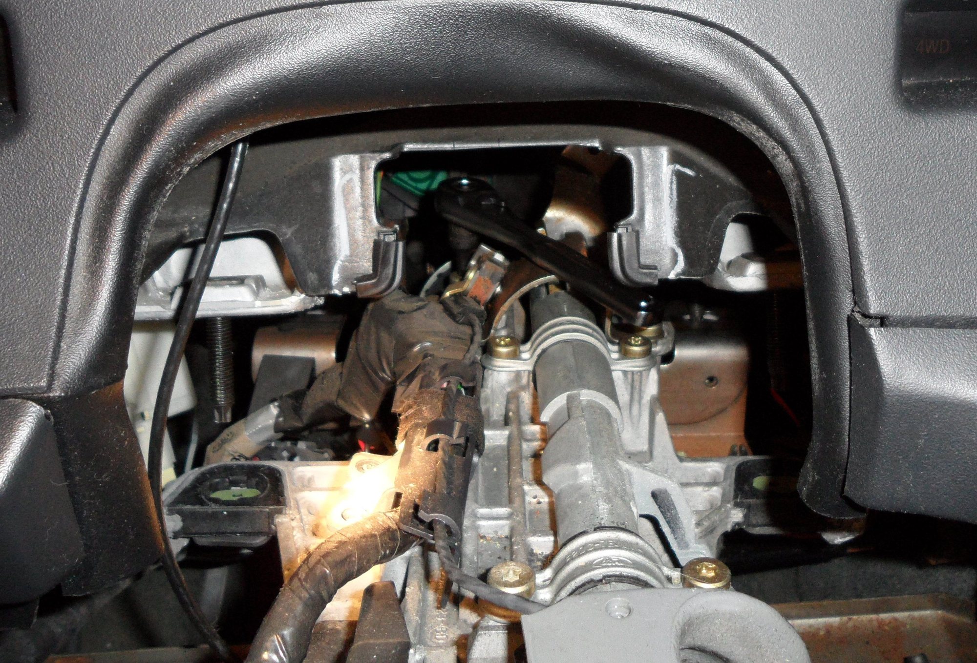

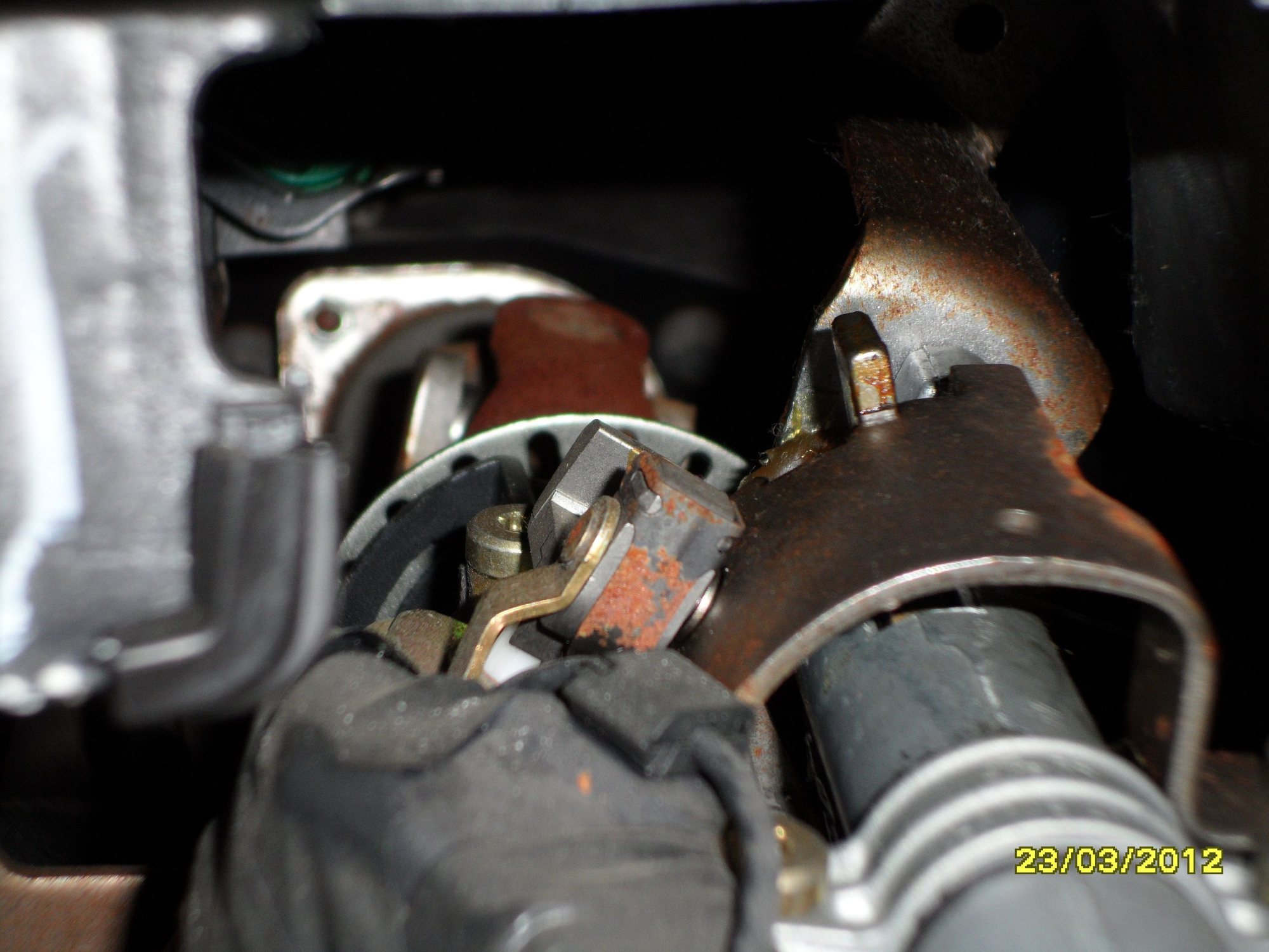

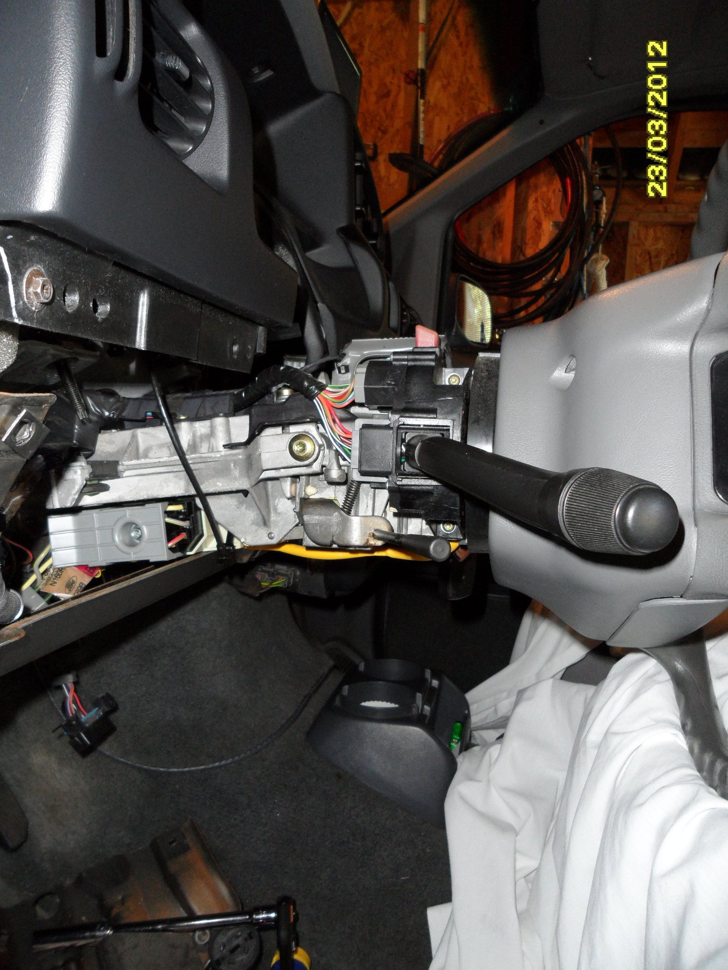

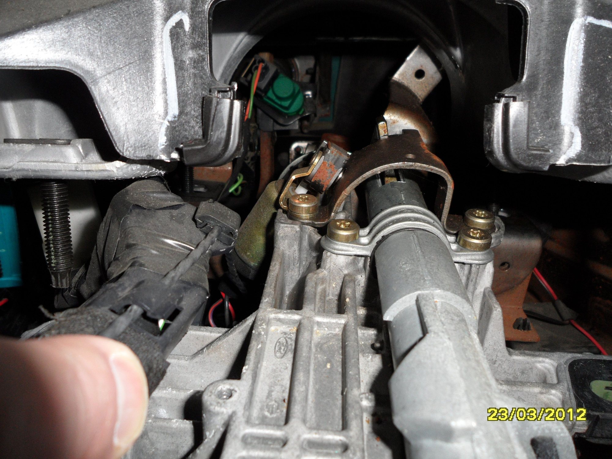

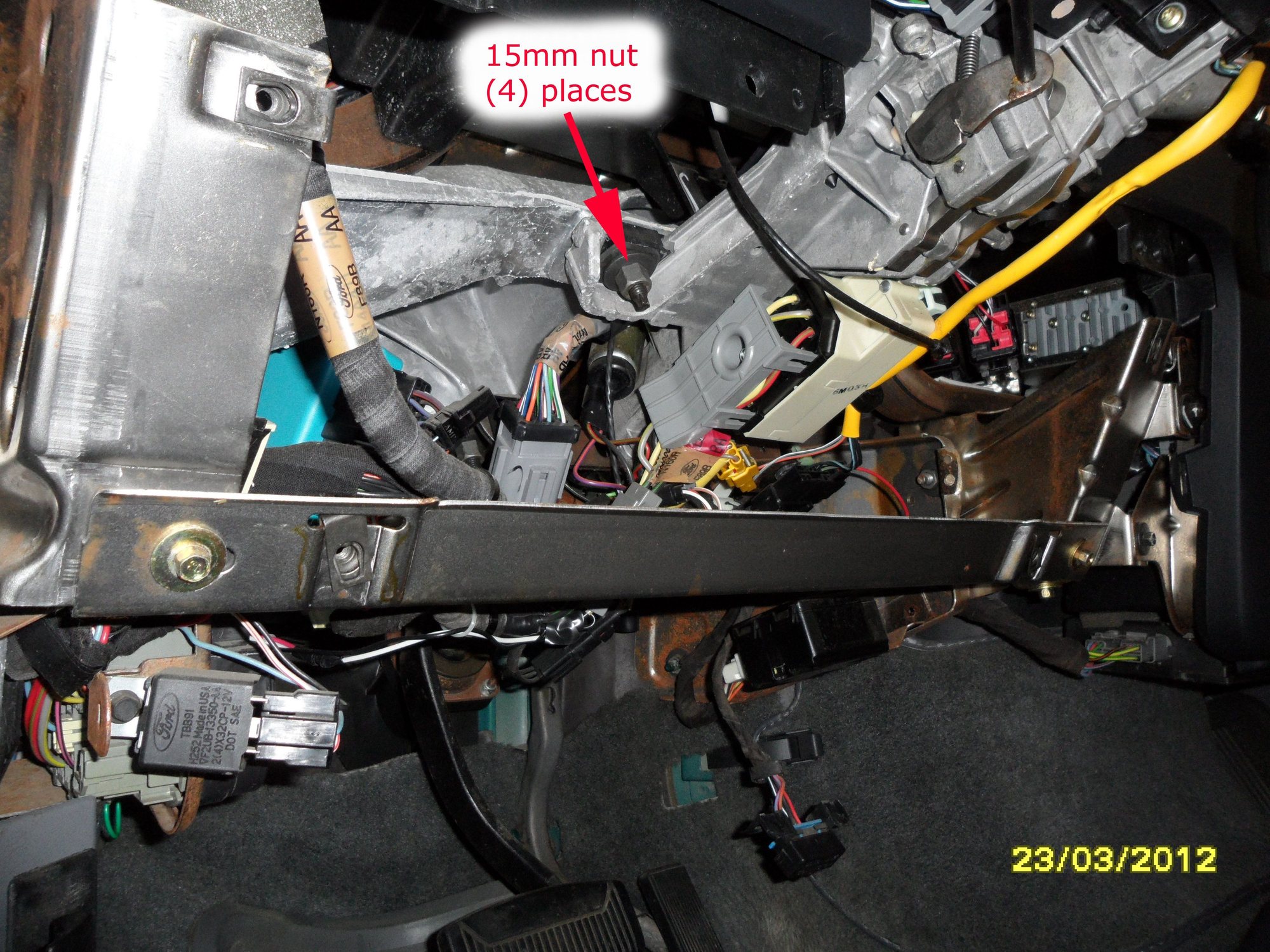

The pics that follow I took back in March. I was in there to lobotomize the shifter interlock, and to make it easier to manually shift to "2" and "L". The shifter was extremely notchy and difficult to downshift, and I'm one of those people who actually use those shift positions a lot, so it was important to me to make it easier to shift. Anyway, I took pics along the way.
Remove the usual stuff: lower panel cover. Disconnect the PRND2L indicator string. In the pic, I unhooked it and unscrewed it from the adjuster, but that's probably not necessary if you're just replacing the shifter tube. However, that cable's 90° fitting breaks very easily, so you may want to unscrew it to avoid stressing it.
Now you can remove the four 15mm nuts and lower the column to access the top of column where the shifter tube's mounted.

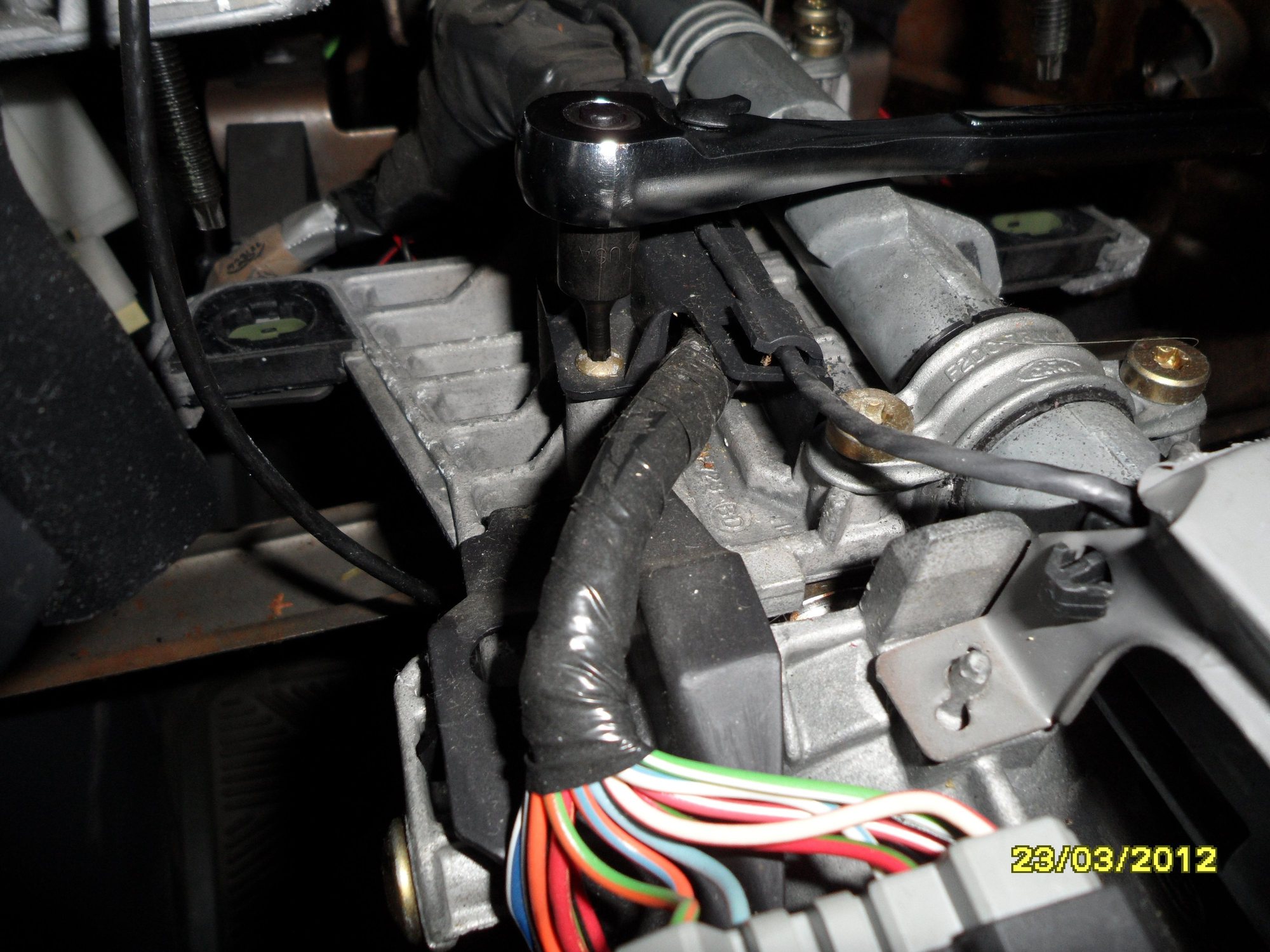

Use a Torx socket to remove the screws that retain the wire harness guide. They're smaller than the tube saddle screws, but I don't recall what size.

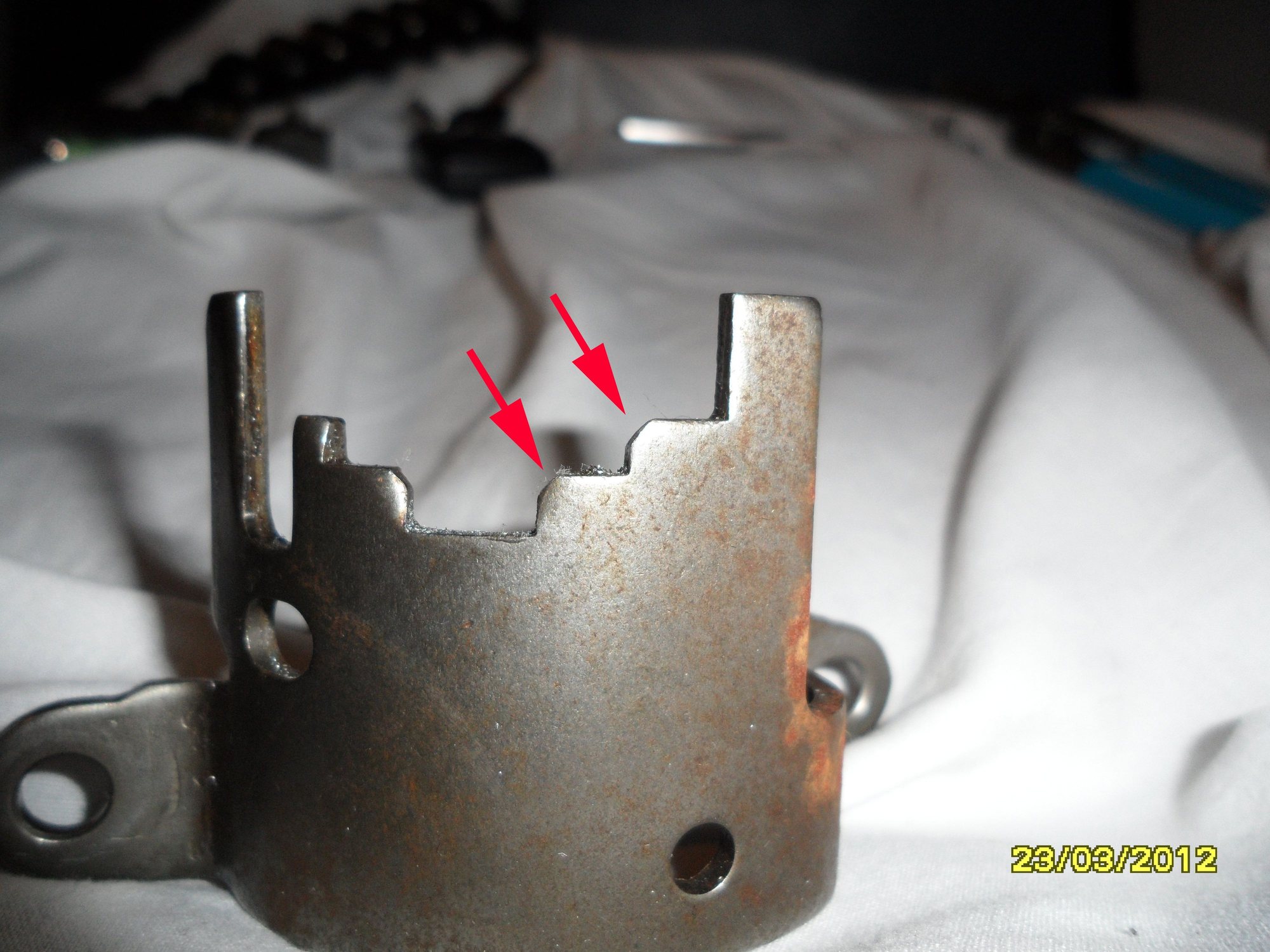

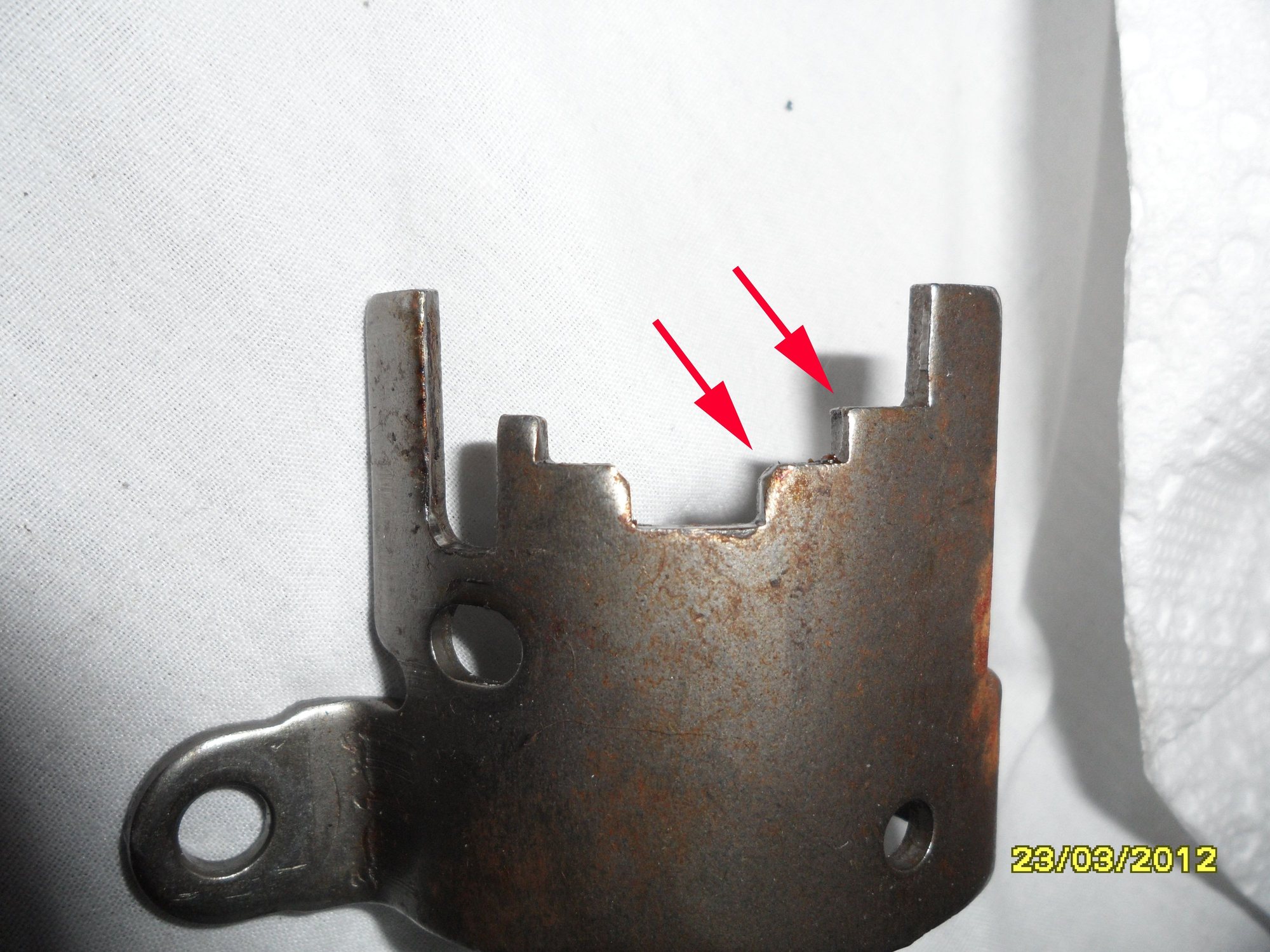

With the wire harness shoved off to the left, you can remove the shifter gate. Torx T30.
This is the shift gate that I was in there to modify. I filed the two corners shown, and that made a world of difference in manual downshifting.
I didn't remove my shift tube, as it's not broken, but I hope these pics help if someone needs to change theirs. I've replaced a couple over the years, but no pics. If you go to the JY, you'll find many of them missing from columns. I think I'd give the Dorman replacement a try, if I had to replace mine.

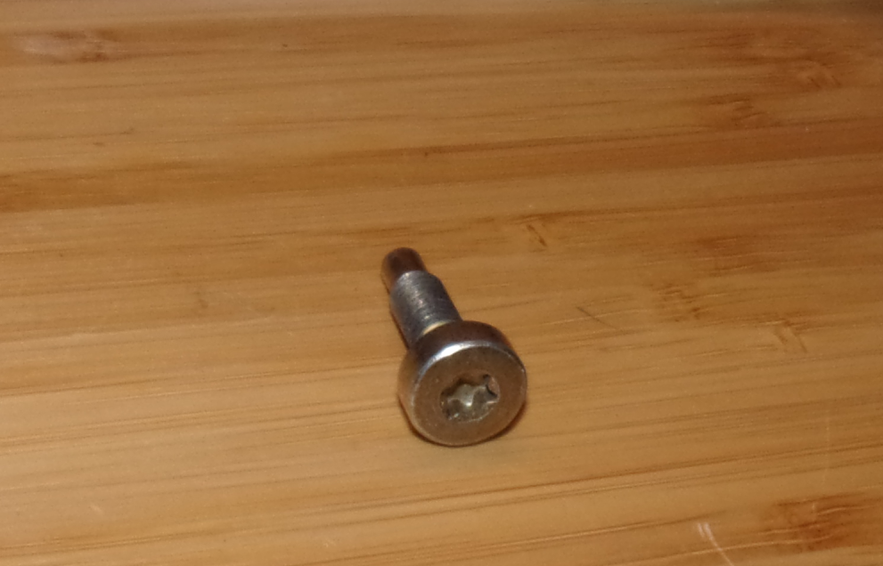

95 Aerostar. Floppy shifter, & found bolt on floor!
Two days ago I went to put my 95Aerostar into drive and the lever felt floppy for lack of a better term. By moving it back and forward I managed to find drive and got home,, and now need to find out what has happened.
I can find drive and neutral and reverse but they aren't showing correctly on the dash needle. I have now found a bolt with T30 head on the floor by the accelerator pedal, (picture below) and looking through this thread and others assume(?) that it has come from the end of the selector as discussed here. I'm having trouble getting under the dash area to try and view the area, so tomorrow I plan to take out the driver seat and try to lie flat and get far enough 'under' the dash with my head on the pedals and see if I can locate the plate and bolts.
If the 2 bolts discussed above are in place and tight am I right in thinking I will have to drop the whole steering column and see if the comb with the step indents at the end of the selector tube has come loose. Before I do that does anyone have any thoughts that might point me in the right direction? Thanks
Found on floor by throttle pedal. T30 head.
