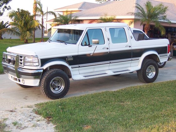

Centurion Has made conversions of the OBS excursions... I have always wanted one of these too
This one has its back top off...
The also made crew cab 1/2 tons...
here is a VERY old truck, non diesel
