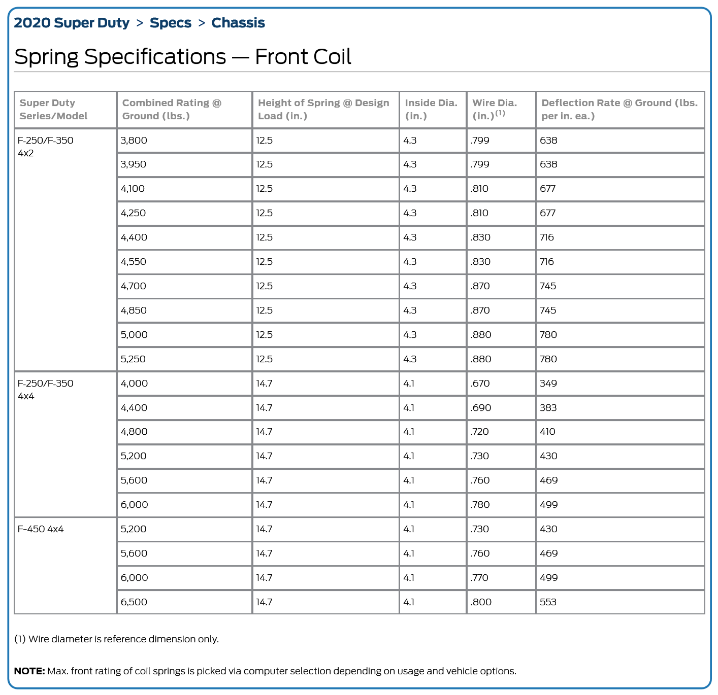

Yes, the 2020 is a 7.3 gas. I did find a post for a 4x4 F250 with a 4000# front suspension, but I am not having any luck finding an oem spring code online. If i could find that spring I could put it on, knowing that I'd loose a little ride height., but I do have the 1.5" leveling kit, so there is a little bit of extra clearance for the bump stop.

Here is the chart I found that shows the 4000# front suspension listing....
