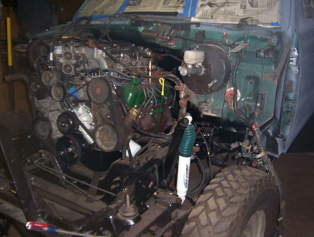

From: Madison Ohio
Been a busy winter so far. I got some time to get back to my project and thought I would post a pic or two.
<a href="http://s601.photobucket.com/albums/tt93/Ohio_ford_farm/?action=view&current=100_0624.jpg" target="_blank"><img src="http://i601.photobucket.com/albums/tt93/Ohio_ford_farm/100_0624.jpg" border="0" alt="start of front clip"></a>

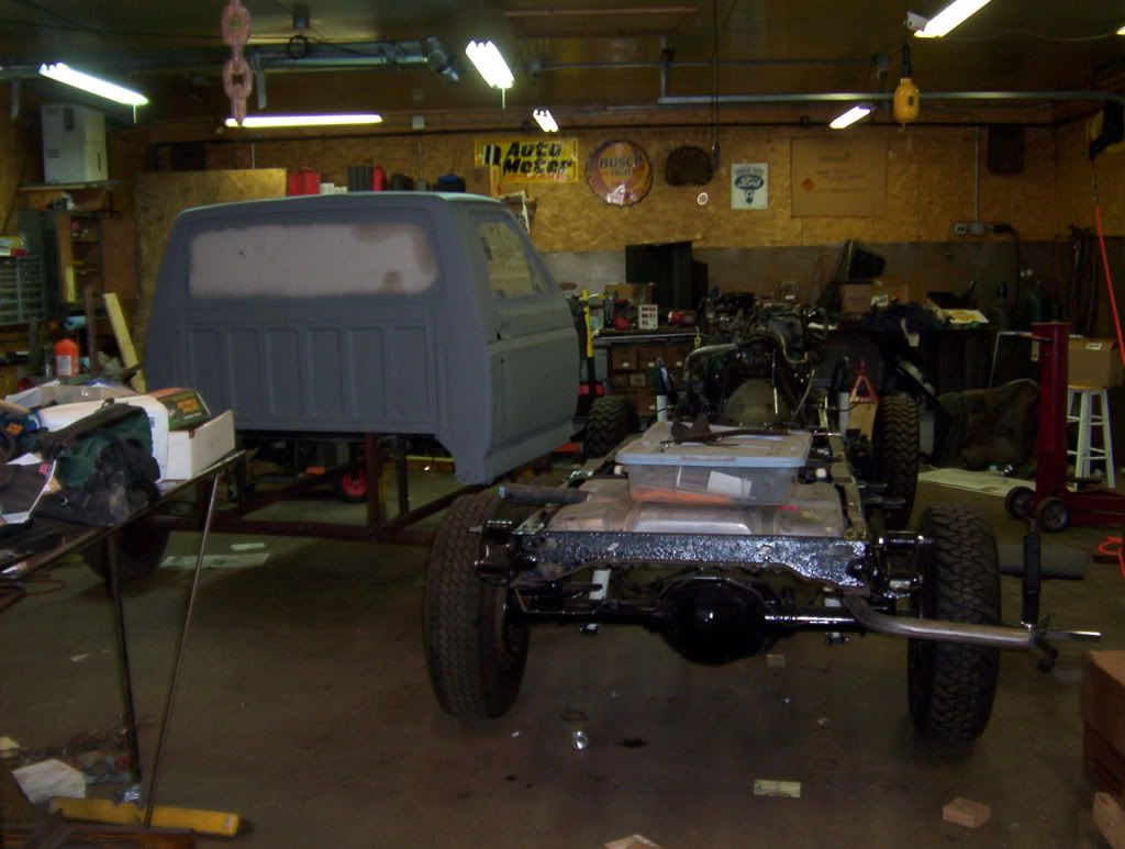

Wish they could do this all the time makes working on sooo much nicer HA!
<a href="http://s601.photobucket.com/albums/tt93/Ohio_ford_farm/?action=view&current=100_0621.jpg" target="_blank"><img src="http://i601.photobucket.com/albums/tt93/Ohio_ford_farm/100_0621.jpg" border="0" alt="cab up frame out"></a>
