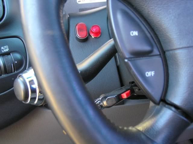

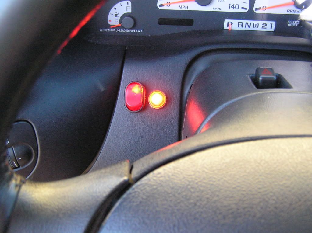

This is the setup on my Lightning. The momentary switch is on my steering wheel tilt adjust.
The main power switch that allows the momentary switch to be active is the rocker on the panel, and the LED lets me know the momentary switch has good juice going to it.
Stewart
