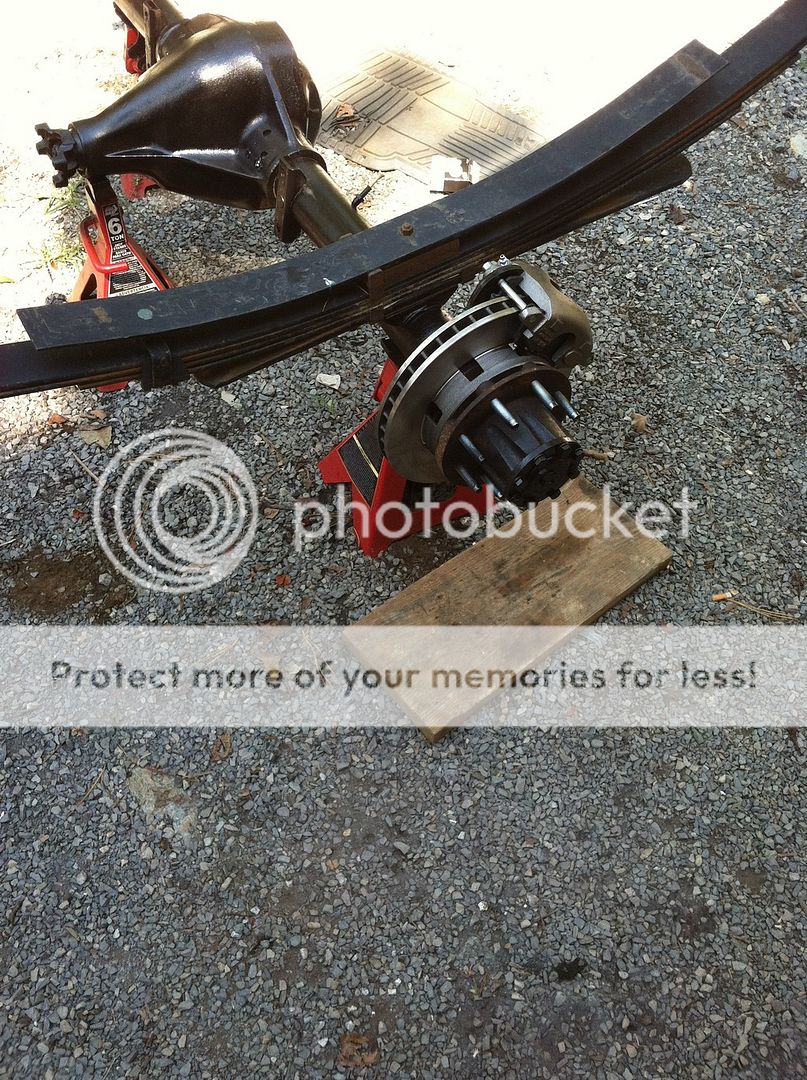

Disc brakes are far superior to drums. The comments by a few in this old thread are comical. I did a disc brake conversion on the D70 I put under my '78 F150. Holy crap did they make a HUGE difference!

Exactly, I find it so ridiculous thay people say that it's not worth it and drum brakes do only 30% of the braking. Congrats. Did you buy the conversion kit or went the route of explorer or some other car from junk yard? Mine is a 86 with a 9" rear end.

Their kit uses 73-87 Chevy 3/4 Ton 4x4 front calipers, with a 96 Ford E350 Van Rear rotor (NAPA#4886799).
