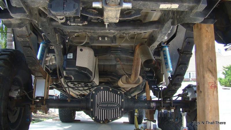

Remove the blocks and go full on deavers, had the same problem when I did my Rize Industries lift.
1 down 1 more to go.
Before, 6 inch block big time axle wrap.
After, Custom, Full on Deavers, no more axle wrap. cost? about 800 bucks does not include shipping and handling
