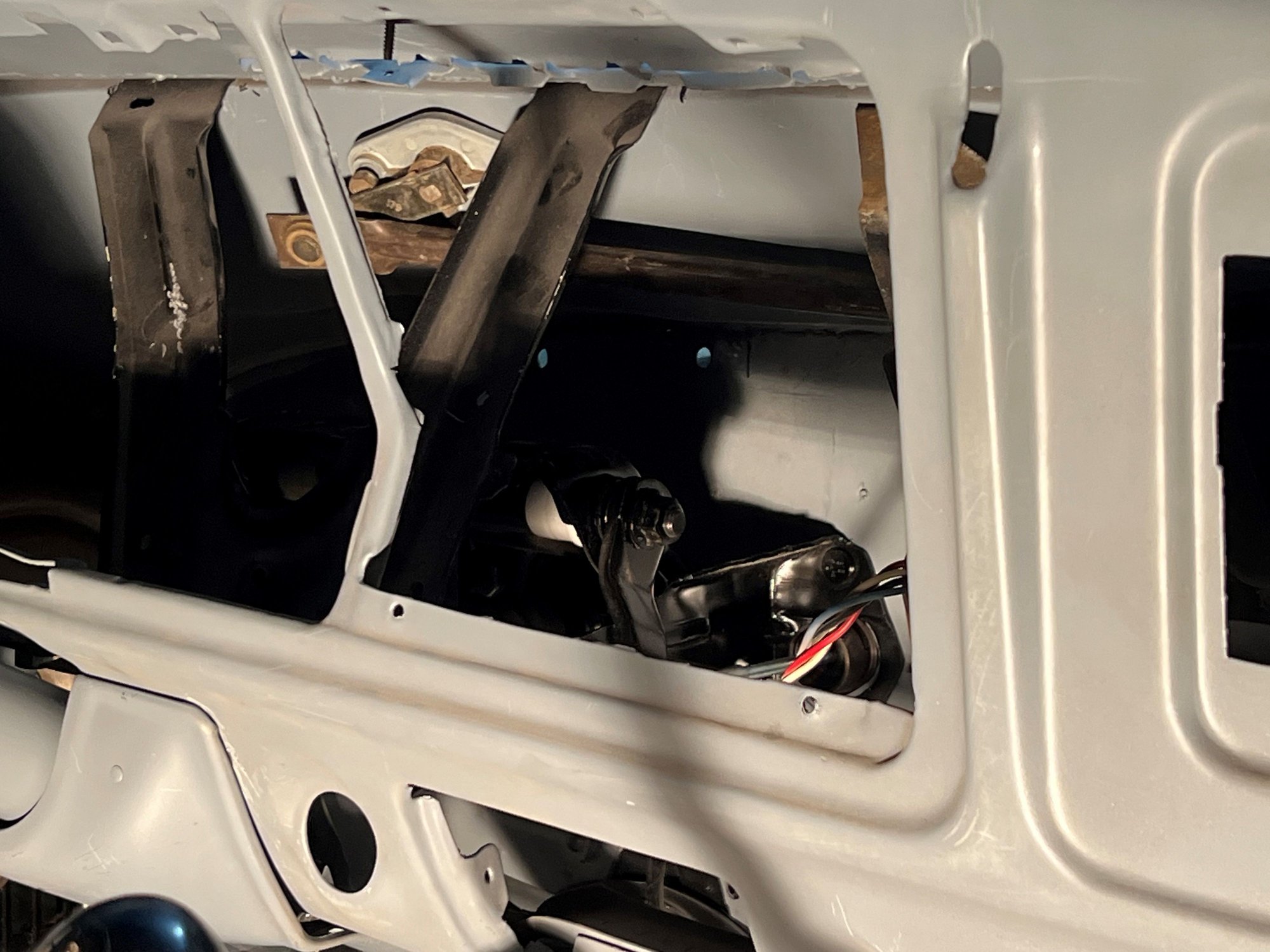

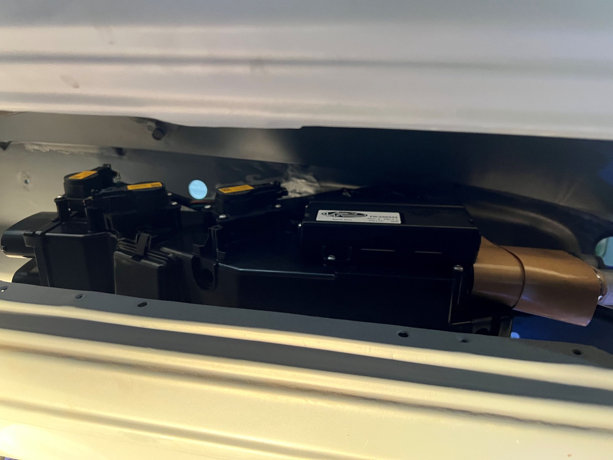

Doing some work on the cab, want to make sure I don't have holes in the firewall that I won't need, so I can fill them. Nice thing about this 79 dash, the front comes off! Only issue so far is the defrost ducts for the 79 are hitting the Vintage Aire system. \May have to heat it up and make a dent in it to fit. Also have to fab up a brace for the center bottom of the dash, and one for the heat box, since the one they provided was for a 67 dash.
AC/heat box barely visible.
Vintage Air system squeezed in. Glove box still fits also.

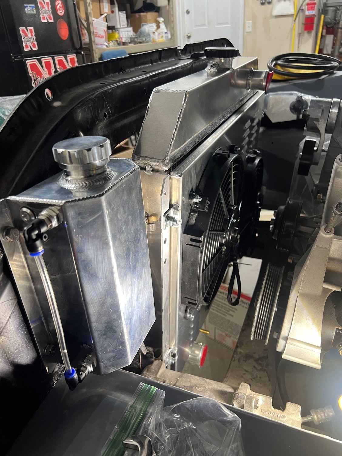

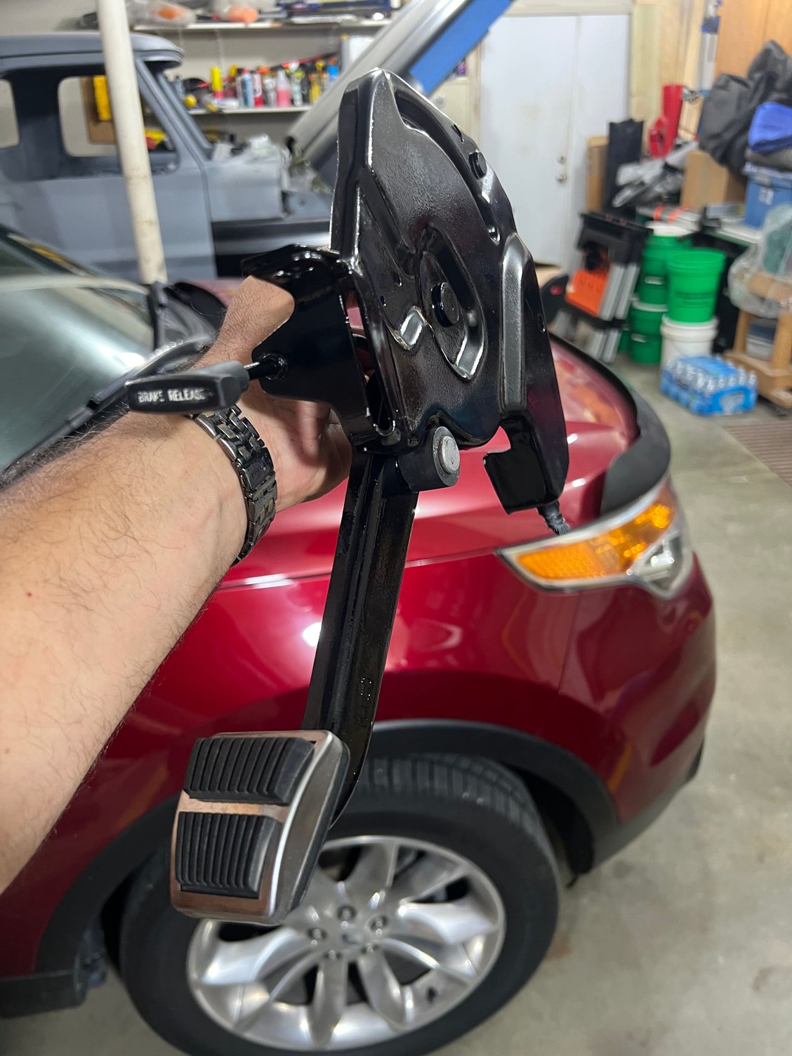

With the rain and humidity, body work has not been happening. So, been cleaning and painting some little stuff for the cab. Also finally got the driveshafts ordered.

Parking brake assembly cleaned and painted, new trim installed on the pedal
Mocked up the overflow can on the core support

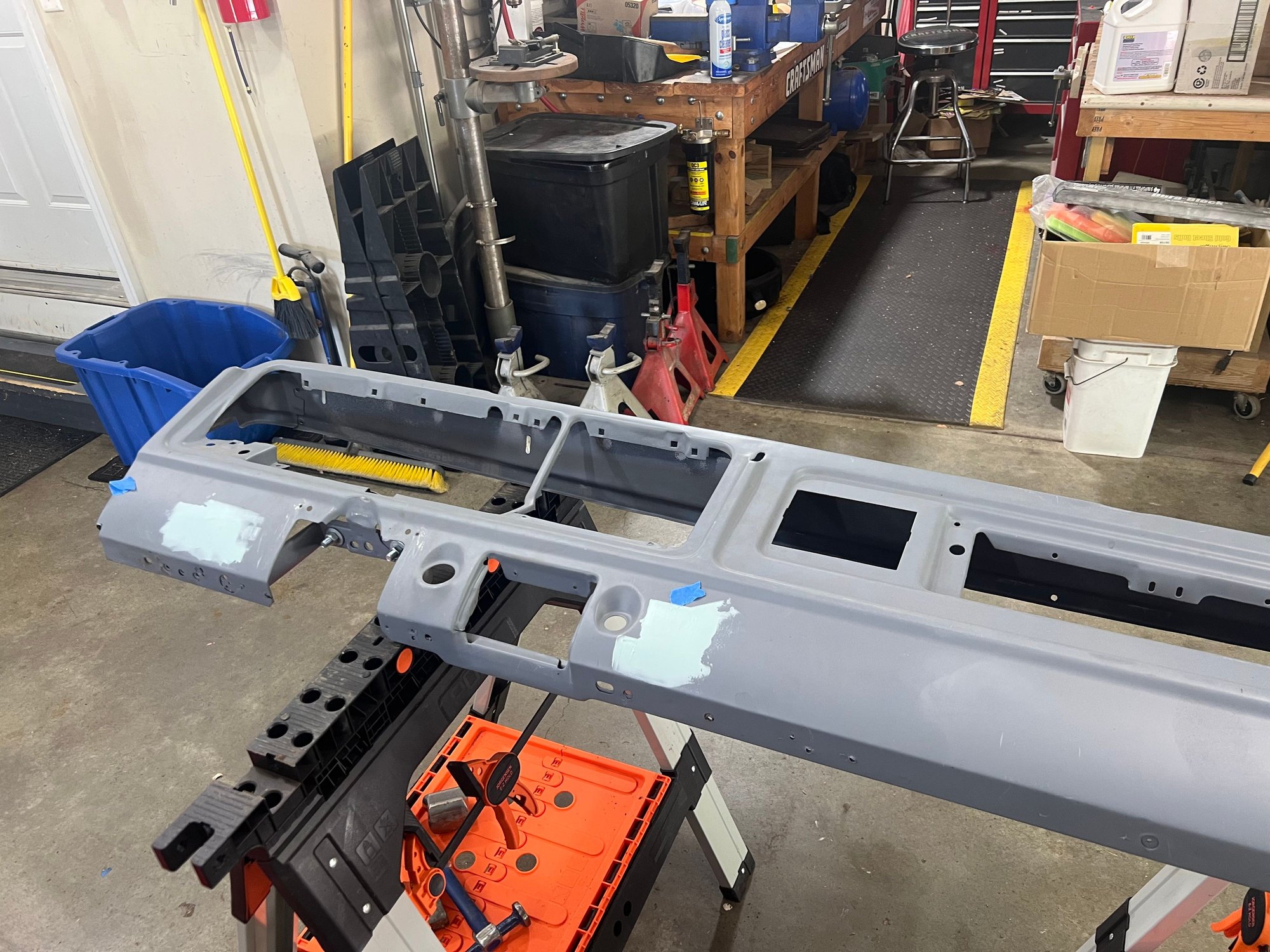

Now that the humidity is less that 95%, can get some body work done. This is just final touch ups before I spray high build primer.
Previous owner had drilled some holes in the dash that I had to weld shut
