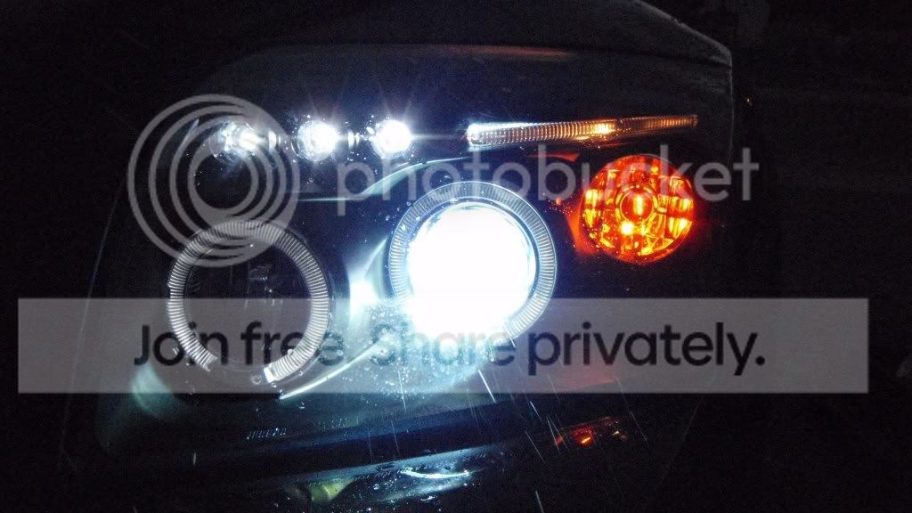

From: Dayton, TX
hids in my 05.
<img src="http://c3.ac-images.myspacecdn.com/images02/20/l_120016ea423844d8becdec833f429dea.jpg">
hids in my 09, trucks kinda dirty though, need to hit the car wash
<img src="http://c4.ac-images.myspacecdn.com/images02/75/l_3f4f4afd9a4246849696b235b6e0a21f.jpg">

You can see where the problem is with fitting HID's into normal reflector from the picture above where the light is diffused all over the place instead of like a projector where it projects the light to the proper area to be lit. Our range rover has 6k HIDs from the factory and they are the same as my old car. BMW, MERC, Porsche, Audi, Jag and many higher end cars all use the same system. Anymore than that and your Lumen output is greatly reduced and you gain nothing but a purple/pink hue. Im not 100% sure but aint anything above 6k illegal in most states anyway?
Here's a pic showing how much cleaner and focused the projector makes the beam.
