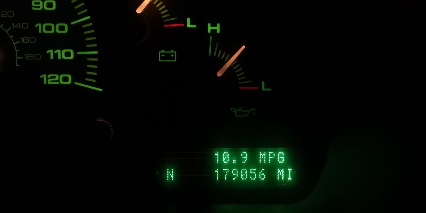

It's my average fuel milage on premium gasoline 98 octane ( in europe 95 octane is standard )
