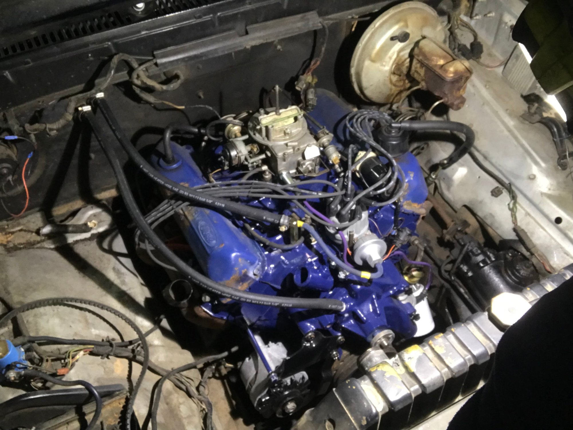

looking for help with decoding the emissions label on this 1976 F100 Custom 4 speed Manual 4WD. Think it’s a 5.9 but for 💩 and grins, curious if it’s legitimate. Label looks to applied over another emissions label.
Drinker’s side restored, repainted.

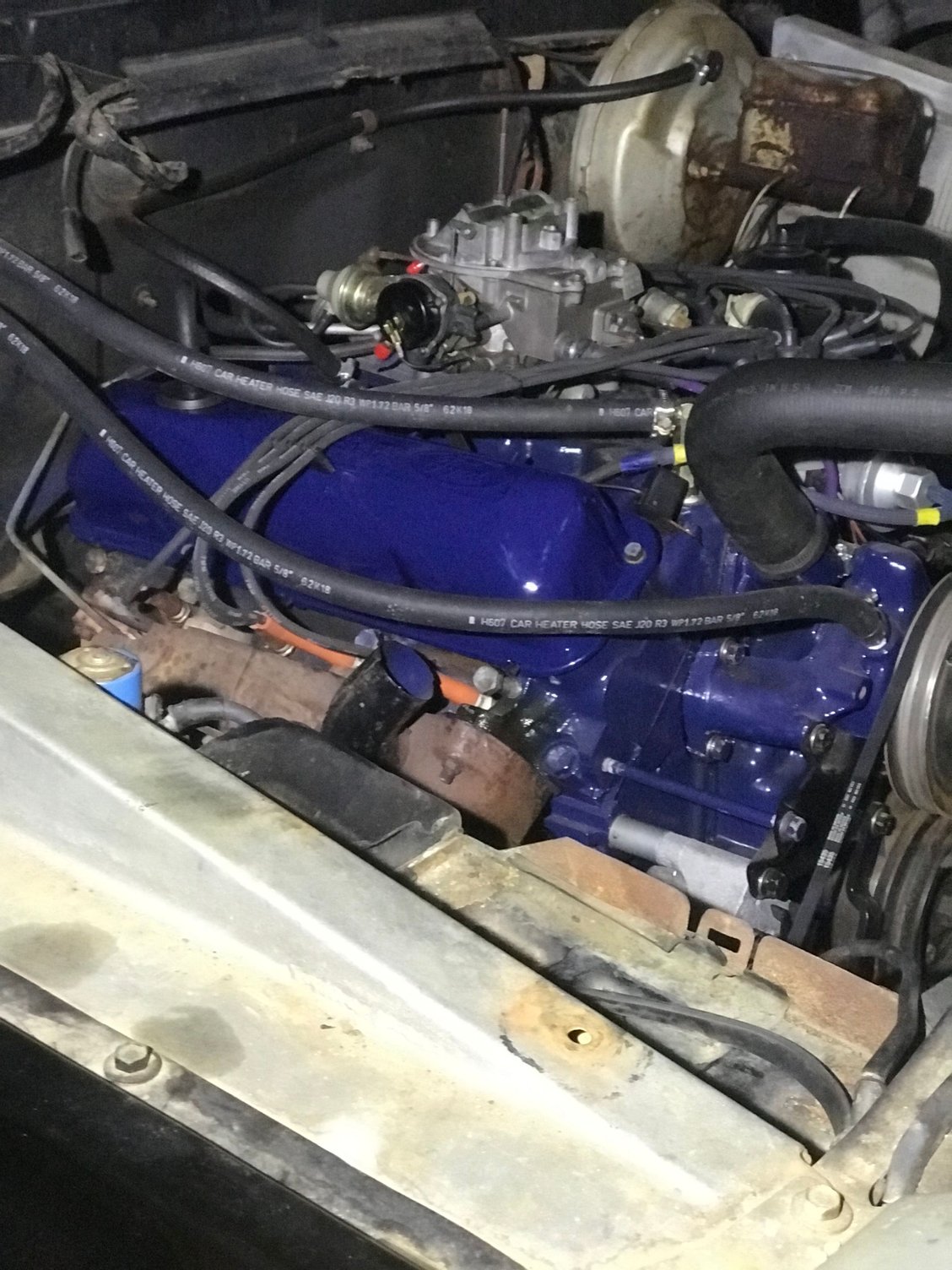

Before I painted drinker’s side rocker cover. 1976 F100 5.9?

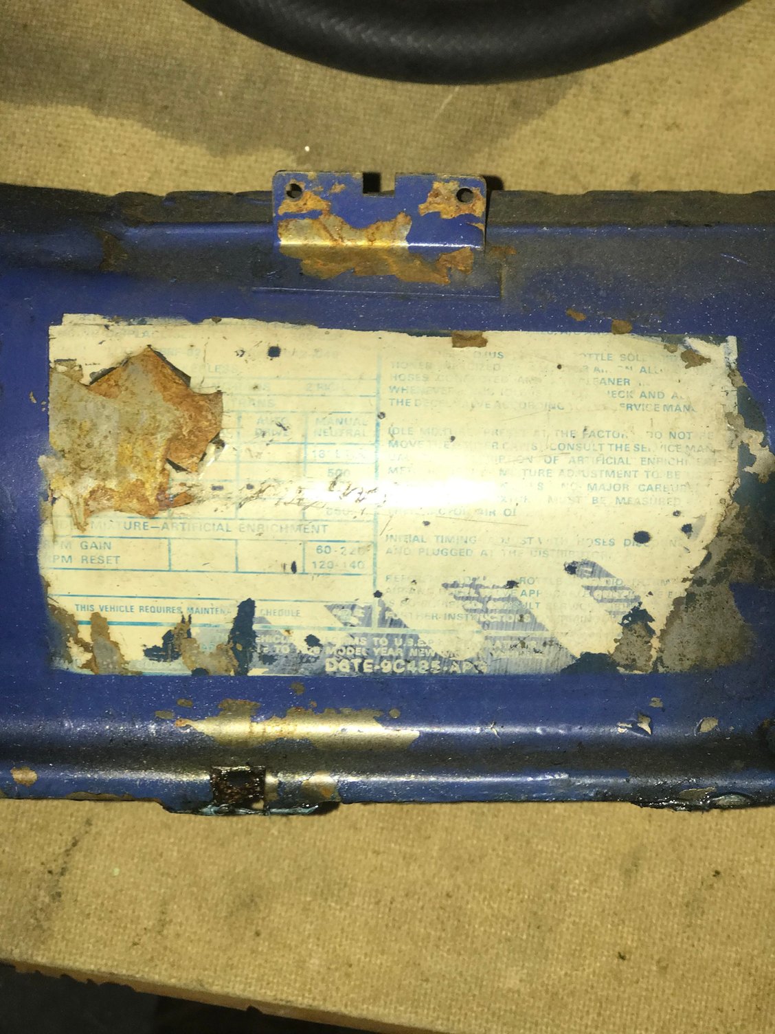

Ford emissions label D6TE-9C485-APG , driver’s side rocker cover 1976 F100. Trying to find a replacement sticker. I can read the Settings for Manual Transmission ignition timing is 18 degrees BTDC.
I saved the best for last, so about to blast / restore this rocker cover. Just looking for help locating an emissions label for D6TE-9C485-APG , I think! Saw the last post on thread was a while ago, but maybe the availability is better now, I don’t know, A guy could maybe help a Feller out. VGG all the way!

I saw those on the interwebs when I searched for D6TE-9C485-APG . Those just aren’t close enough in specs. This one states barely legible Manual Trans 18 degrees BTDC , etc, etc. The truck has been de-emissioned, air pump removed, tank was converted swapped to a non vented tank before I took on the project. Yet several things are not correct. EGR valve was connected to constant vacuum source on the front port of the 2150 2V carburetor. Non vented step side gas cap was not removed however and there was a fuel filter added between the 2150 carb mounted fuel filter and the fuel pump canister style fuel filter built into the pump body plus the strainer in the tank. Lots of suction but with the wrong fuel cap and all those filters, no wonder it ran like 💩. Like holding yer finger over the top of a drink straw. Need suggestions on finding a vented cap that will fit the non vented step side deep reach style fuel cap or find a different year step side filler neck with vented fuel cap and swap the entire filler out. Apparently the reach depth of the cap is different from vented vs non vented fuel caps. Also would like to find better air pump port block off’s on the cylinder heads instead of what the PO installed which are huge 3/4 hex head bolts.
