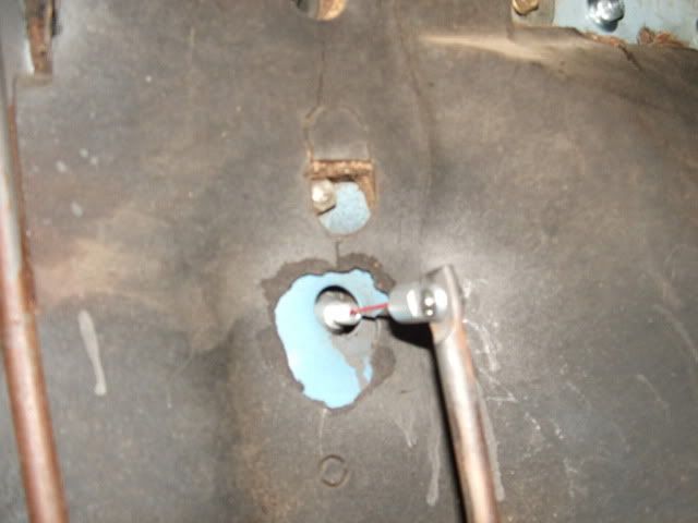

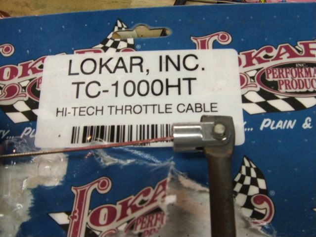

Well you may already have your problem fixed but I'll post this for the next guy who uses the search function.
I have a Lokar high tech cable, but I imagine it should not be any different than the universal cable as far as mounting. The only difference is probably the braided line. Remove your gas pedal by removing the 3 bolts on the outside bracket. Also slide the retaining clip back on the line hooked to the pedal. Here is what you have.
For the kit I used you need to remove the stud from the gas pedal. It is cast and you can bust it off with a little effort. You could also drill it out if thats what you want to do. The original hole is exactly the correct size for the pin that comes with the kit. I would not over drill it, but thats up to you.
The original cable hooked up as mentioned to a post. This kit I used hooks directly to the pedal. To correct the offset issue I straightened out the pedal so I would get a direct pull.
Used a washer on each side of the bracket to take up some space. This pic shows the bracket mounted back on the truck.
Inside of cab.
As for mounting to your carb, my setup is definately no longer stock, so your kind of on your own there. For anyone interested, this is what the complete throttle cable and c4 kickdown kit looks like.
This is by no means a complete set of instructions or the only way this could be done. I considered cutting the old bracket apart and destroying the cable in the process, but opted to just go with the washers to take up space. 10 years from now someone with a straight 6 may need a cable and I'll make a couple bucks.
