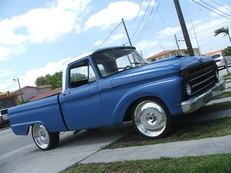

my name is Yaril, i found this forum cause i am currently building a 65 Truck for a local guy. so i thought i would show you guys what i am doing... his goals are to have the truck lay frame on 20 / 22 (not my choice of wheels i like old wide whites). well guess ill just post pics and info as i go. any comments or advice is welcome. here goes...
here is the truck as arrived to me:

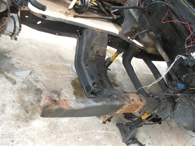

motor gone now the huge cross-member can be eliminated for the MII:

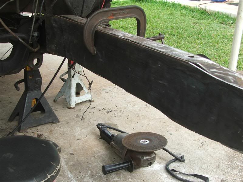

cross-member gone, made plates to box the frame:

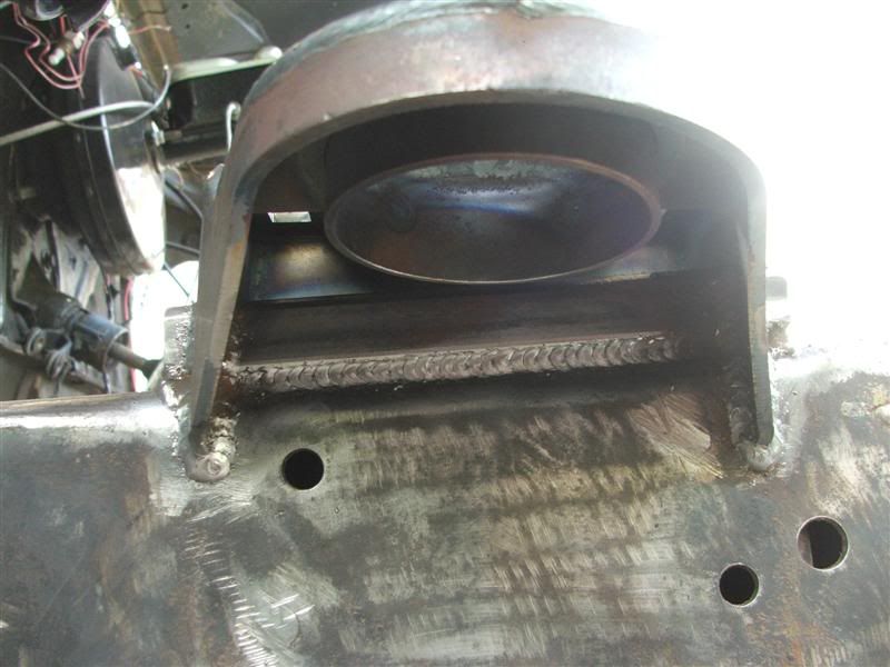

boxed, MII tacked in place (notice i raised the cross-member & top hats 1" for more slam):

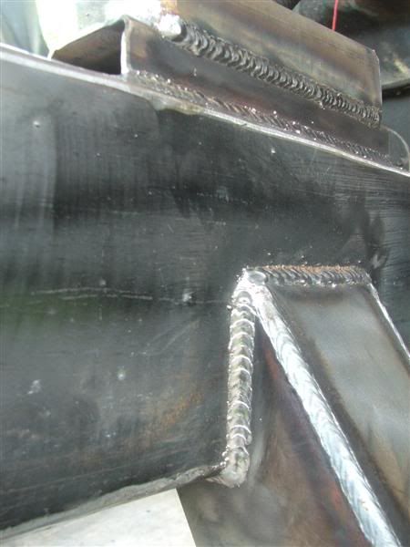

welding the MII to the frame:
more welding:

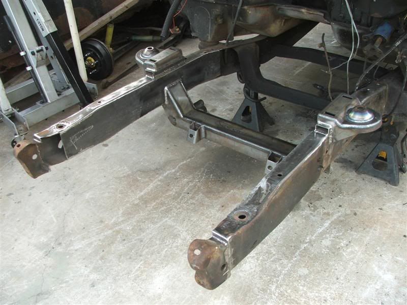

frame almost ready, still need to pipe notch for R/P and install shock mounts & motor mounts:

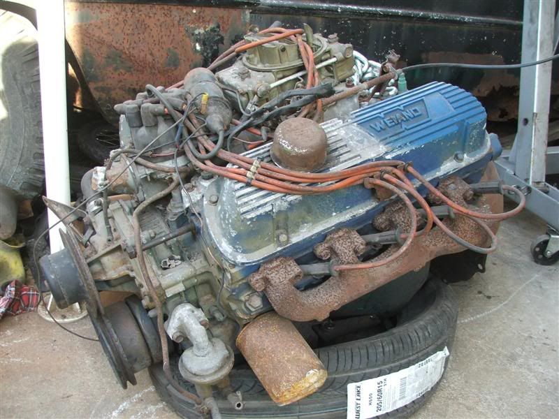

302 to be rebuilt but currently going to use it for mock up when the T5 gets here:

I think you have a twin brother lurking here called brandon wilson. My welds have never looked that good. Keep us posted.

Yea nice welds. I weld 40 hrs a week and some of your out of position stuff kicks mine out. Dont like slamed rides. But, good luck.

I was noticing how accurate your cuts are. Are you using a plasma cutter in the fabing of your metal? I've been using the cutoff wheel and my 4 inch grinder along with a sawsall and its not anywhere as clean looking as your work. Your welds are top notch. Keep the pictures coming.

as for the question about cutting. for now i use a 4.5" cut off wheel. thats all i got. it makes accurate clean cuts. i am looking into a plasma but not in a real hurry.
