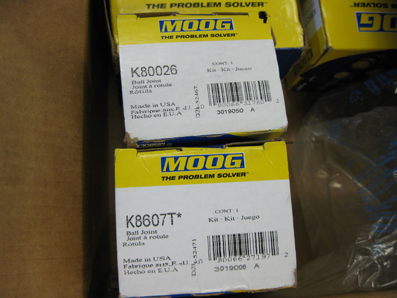

Originally Posted by mhoefer
Word is the Moog are not as good as they were, made in China.
This is either untrue, or I just received a batch of old stock.
Came in the mail today...
Old Apr 27, 2009 | 07:17 PM
Desert 4x4's Avatar
Desert 4x4
Joined: Jul 2008
Posts: 117
From: So. Cal
Baja where did you order the moog joints?
Old Apr 27, 2009 | 07:23 PM
1975StroppeBaja's Avatar
1975StroppeBaja
Joined: Apr 2006
Posts: 3,215
Likes: 8
From: WV
I got 'em from amazon.com. They had a good price and shipping was free. I was going to get the kit from powerstrokeshop but when I entered my address it showed $43.65 shipping!
Anyway, I bought the ball joints from amazon and the seals, o-rings, and needle bearings from FTE/PARTS-GUY.
