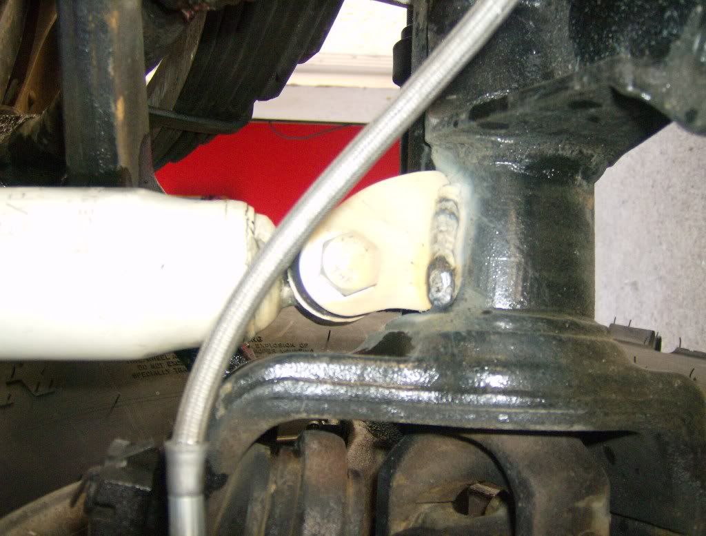

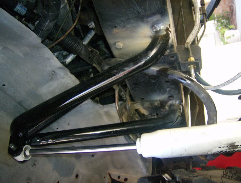

An example of a custom mount used in one of my trucks:
An example of the lower tabs after being welded in:
This configuration will reall open up the options for the use of more current shocks. You can pick and choose what set up you want. You will not be limyed to just old style twin tube shocks any longer. Up grade the mounts and get some fancy new shocks.
