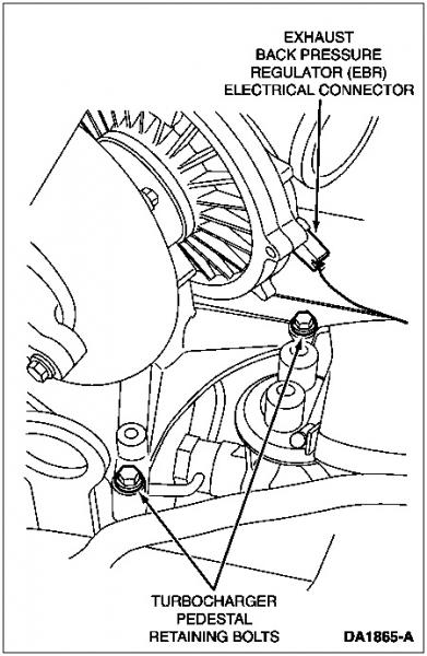

EBPV, Exhaust Back Pressure Valve. Here's a picture of the connector you should disconnect to deactivate it.

Thanks! I just pulled the plug and started it up. No drop in RPM. Are there any side affects by disconnecting the EBPV.

No ill effects. It's supposed to speed engine warm-ups in cold weather. I' didn't notice any difference after I disconnected mine. Just about everyone here has disconnected it or gutted the entire valve assy for the reasons you already discovered. If you continue to have these symptoms you can wire the valve open. Look here:
https://www.ford-trucks.com/forums/a...1&d=1157845225
On another note, it could be used for an exhaust brake if you tow heavy in hilly conditions by wiring a switch on it into the cab.
