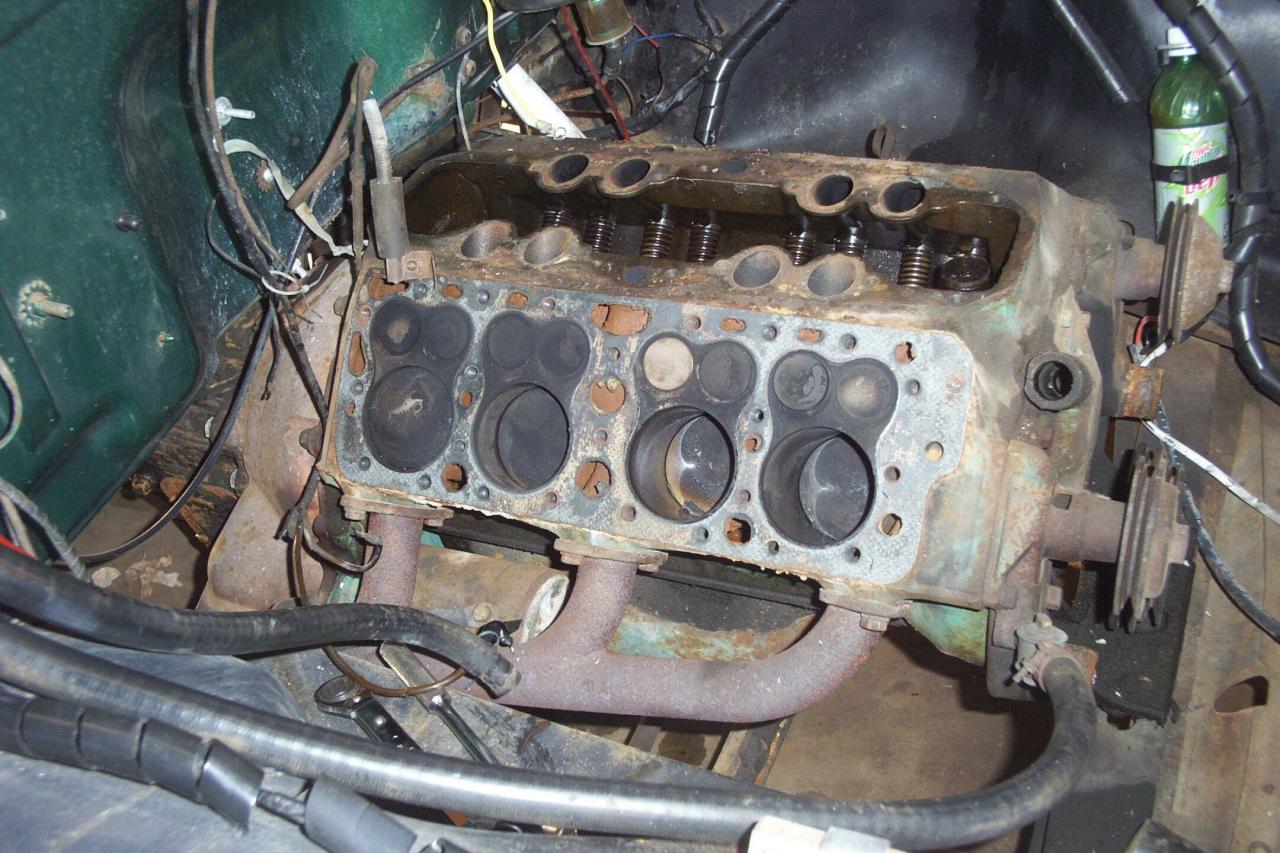

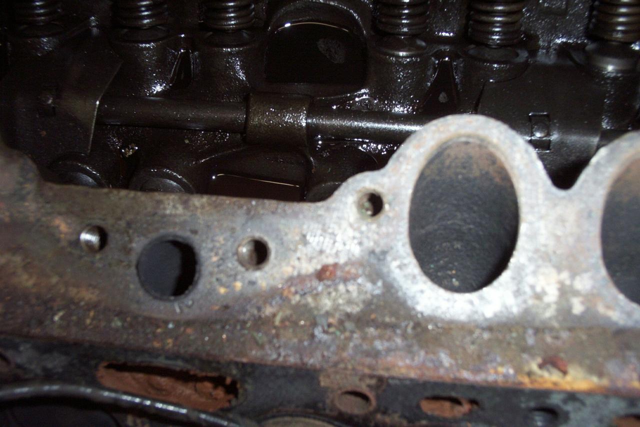

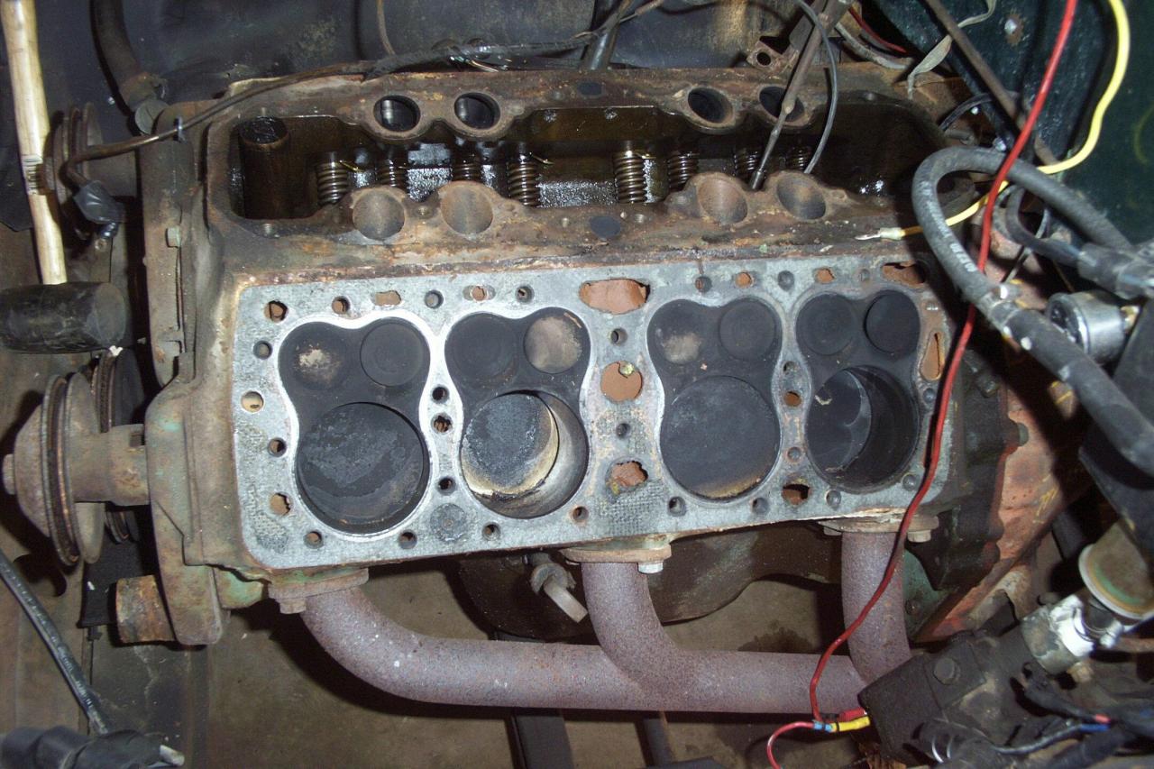

well i was tired of trying to straighten the black hole up, so i decided to add to the clutter instead . i pulled my heads off the flatty . unlike our resident cave man i am in awe of the great shape mine is in . other than a lot of carbon on the bolts , and in the cylinders she's in exceptional shape . no leaks around the bolts as i have heard of and been warned of . the gaskets were leaking on both sides , the drivers was the center water ports and the rear ports , the paassenger side was the center ports and the front water ports . no visible cracks or anything paculiar to be seen , and the valve that has the weak spring is intact and undamaged despite being beat on for so long . the lifter galley is ultra clean { something to do with religous 1,000 mile oil changes and constantly fussing over it i think ! } and no gook in it and all else other tha some grinding in the water pumps , is aok . well i'mstill gonna pull her up to replace some gaskets that are leaking a little bit , , a good thorough cleaning , and repaint , as well as replacing a few worn parts , and hopefully a wee bit of a cam . i lied to the wife told her it had a cam lobe that was flat spotting , not totally gone but on it's way ..... BAD KEVIN welp later guys im off to slumber land , 2 am comes too early .

this is before i scraped off the remaining gasket material ....Name:  My Pictures0001.jpg

Originally Posted by 55 f350
this is before i scraped off the remaining gasket material ....Attachment 13920
Attachment 13921
Attachment 13922
Looks to be in good shape. That carbon should have protected the cylinder walls very well.

I donno.......sure looks like you could lean it out a little.......

rusty it's an overflow that was quickly improvised when she started to push coolant out pretty badly , then it quit after i cobbled it up ! as far as leaning it out rick i have done everything including going through that carn sarned holley , and it just won't do it . thats one of the reasons i'm switching it over to a rochester . you think it's bad now you shoulda seen how rich she was running when i first got her , and after 20 plus of sitting inoperable . yep havi , my dear caveman , that's kinda what they look like . would like to talk to you and see if your's thats junk had the factory aluminum intake and / or timing cover of the light stuff . thinking about maybe putting some shiny stuff on her ........ da-n i'm gonna turn into a gold chainer if i ain't careful !!!!!!!!!!
