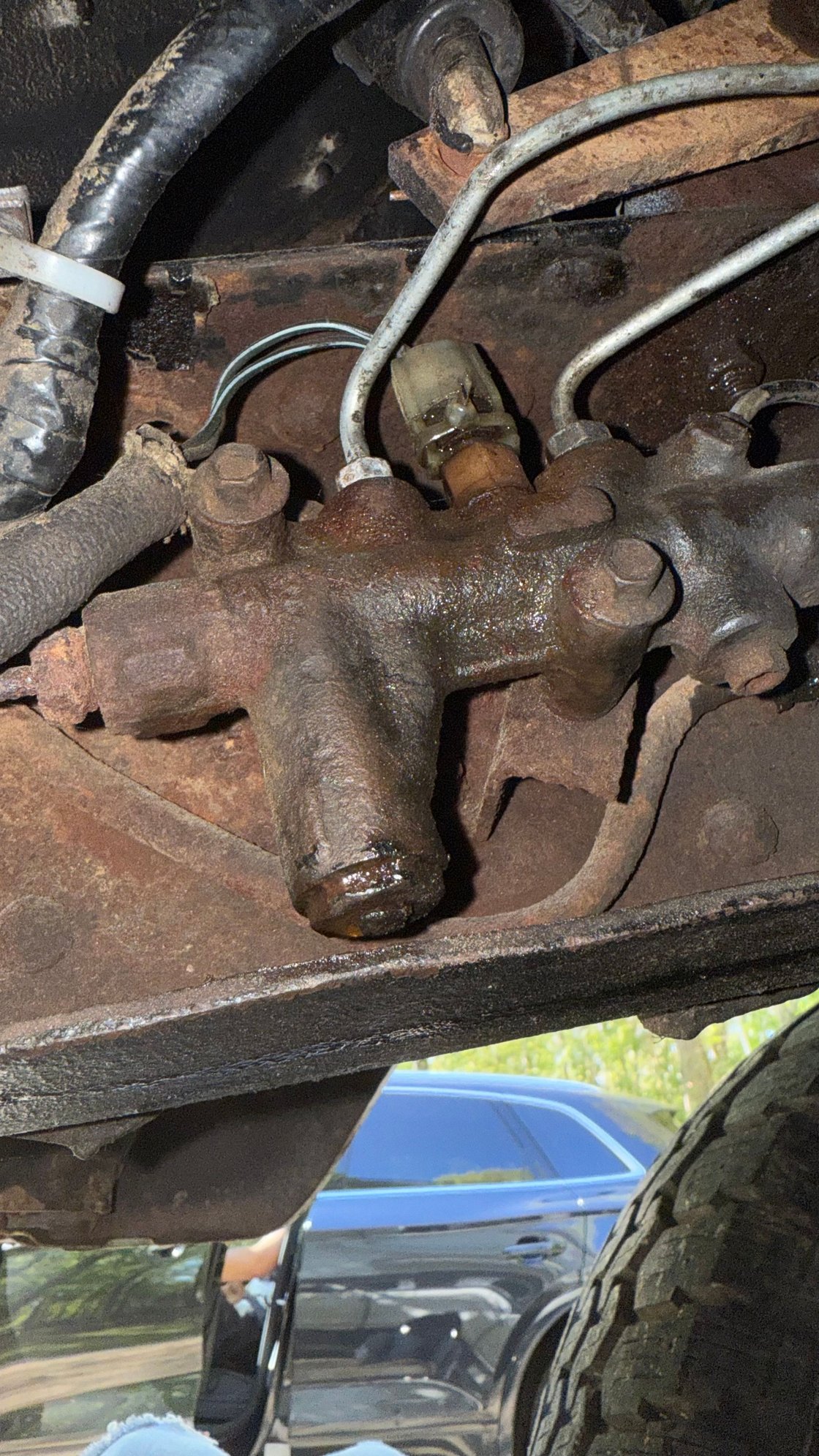

Can air get sucked into the prop valve?
I have bled the front calipers with easy, predictable success. I have replaced the master cylinder. I have rebuilt and adjusted the rear brakes. I did not replace the rear brake cylinders, but they are not leaking. Every time, HUNDREDS of times while bleeding the brakes, there is a 1 to 2 inch chamber of air immediately followed by a column of fluid.Tighten, loosen,repeat… the same thing for literally hundreds of times. I have not let the master cylinder go dry.
I am wondering if the prop valve can be sucking air into the rear lines.
there is moisture at the top (where the plug enters) and some at the bottom (with the little rubber nub thing).
my brake pedal goes all the way to the floor with negligible breaking power. It is always slow to return the pedal to the upright position.
my gut says the prop valve needs to go. Is it safe to delete it?

It is there to balance the breaking front to rear and also turn on the "brake" light when the PSSI between front & rear is different like a leak from a bad line.
The front dose most of the breaking as the weight shifts to the front when breaking so a little less breaking to the rear helps to keep the rear tires from locking up even more so when empty.
Later years they added an adjustable valve out back that was hooked to the frame & rear axle. When empty it would cut the breaking even more and when loaded and the frame came closer to the axle you get more rear breaking.
Over the years the valve would go bad and not get any rear braking.
If you dont care for the light I dont see why you could not pull that plastic switch and install a plug just make sure it dose not go in too deep and it will keep the valve from moving when needed.
You are better off finding a good one and swap it out.
I dont know how you are bleeding the rear brakes but I have found the bleeders can suck air in and make it look like air is in the system.
With a helper pump pedal 5 times slowly or the master will not fill, and hold they tell you they are holding, open the bleeder and they keep their foot to the floor till you close the bleeder and you tell the to pump 5 times again.
I do this 3 or 4 times at each wheel but before I move on to the next wheel I check the level and top off as needed.

I admire your perseverance. Most people admit defeat after about 20 attempts at brake bleeding. There's a quirk with brake bleeding due to how this valve works. Details here, including more info about the three very important functions of the valve:
https://www.ford-trucks.com/forums/1...-bleeding.html
Should you just delete and bypass the valve? How are you under pressure, testifying under oath in court after slamming into a bus full of nuns and orphans? The valve is there for a very good reason. On the slim chance the valve is bad, replacements are available here:
https://www.carolinaclassictrucks.co...ion-valve.html

In order for air to enter, fluid must be leaking out. A brake system must be fluid tight. If you are losing fluid you need to chase down the leak. One place to eliminate is the brake booster can. Sometimes the master can leak putting fluid into the vacuum can. The hidden leak.
For the rear bleed adjust the brakes all the way into the drum. After your bleed adjust the brakes for a light drag.
The rear proportional valve limits fluid from the rear brakes unloaded. When loaded more flow to the rear. It might help to load up the rear for a bleed? I haven't done that before but when having trouble bleeding it may help. Is the rear proportional valve hooked up?

On the later trucks they went to RABS and the factory did away with the proportioning valve. The RABS system frequently fails and is difficult to get parts for. So I bypassed the valve on my 89. It's like driving any older truck with the single master cylinders. Normal operation you do not notice any difference. If you have to get down hard on the brakes in a panic stop, you can feel and hear the rear tires sliding.
