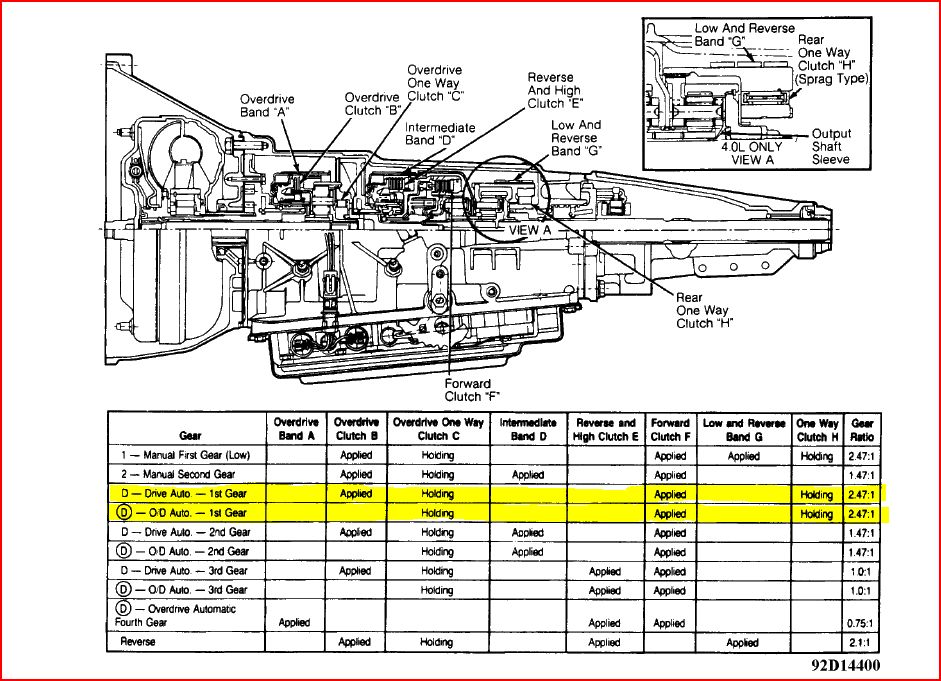

In the OD selection, in first gear the overdrive one way clutch and the forward clutch and low one way clutch are engaged.
In D selection, in first gear the overdrive clutches and the overdrive one way clutch, the forward drum and the low one way clutch are engaged.
The problem with your transmission is the overdrive one way clutch is broken. It is a common failure for this transmission.
Why it moves in D is that the overdrive clutches come on and drive the hub that the overdrive one way clutch was suppose to.
Name:  A4LD Clutch and band.JPG

JK080, thank you for the info and the pic....so what is the best way to solve this? I have found some "master rebuild" kits but did not see any that says they come with one way clutch's....do you have to buy these separate?
