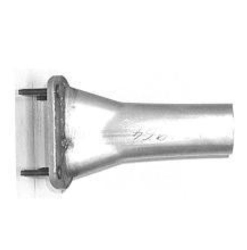

Originally Posted by Furian
If it were me, I'd replace your OEM cat with a single high-flow cat from Bear River Converters. That will provide some performance gains and significantly shorten the distance from the Y-pipe to the muffler. This will provide you more than enough space to do the exhaust tips in front of your rear tire. You already have a great Magnaflow muffler so the only new part you need is the high-flow cat. There is an adapter on eBay that allows you to keep the stock Y-pipe exit but mount the standard round cat. It's about $35.00.
Catalog Items
Hey Furian----do you know if they make those adapters for the V10?
Bear River----Is there any sound clips of your mufflers or muffler/cat combos out there anywhere?
Old Apr 2, 2009 | 06:13 AM
Furian's Avatar
Furian
You Keep What You Kill
Joined: Dec 2006
Posts: 4,902
From: Huntersville, NC
If you have a V10 engine, then you have a Super Duty truck (1999-present) and should not need this adapter. This specific adapter was made for the older F-Series trucks (1992-1996) that had a rather large single cat after the Y-pipe.
Old Apr 2, 2009 | 12:43 PM
cmullins's Avatar
cmullins
Joined: Mar 2009
Posts: 66
From: Rochester, MN
Yes I know that but doesn't the SD V10 have a 3-bolt flange on the pipe in front of the cat? Same rule would apply. If you had an adapter for the universal cat you wouldn't have to chop the flange off of the stock converter.
Old Apr 2, 2009 | 05:46 PM
Furian's Avatar
Furian
Joined: Dec 2006
Posts: 4,902
Ah, I see what your saying now... the flange on Part #3 below (arrow point at flange). I assume that you have 3" exhaust tubing. I believe that is a standard exhaust flange that can be provided by a local exhaust shop or found on eBay. See the pic and eBay links below:
eBay Motors: Exhaust header flange pipe 3'' collector kit clamps (item 300303511537 end time Apr-02-09 17:43:41 PDT)
