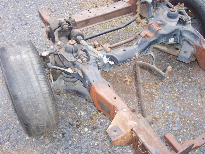

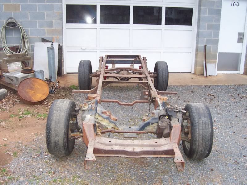

56panel as soon as I can get my galleries working I have some pics of a 96 CV IFS and Rear end done up in a 56 Frame. Will post later
Old Feb 27, 2009 | 10:32 AM
thepitshop's Avatar
thepitshop
Joined: Jun 2006
Posts: 1,159
Likes: 28
From: manitoba
is this your next project tacson?? looks like the 96 clip is easier to blend in than the 89 clip into the truck frame, looks really good!!
Old Feb 27, 2009 | 12:10 PM
tacson's Avatar
tacson
Joined: Apr 2003
Posts: 2,578
Likes: 208
From: Murfreesboro, Tennessee
No I was out to my friend who has taught me all I know about FOMOCO clips and this was a frame he just finished for a customer for his 56' BW. Here are more photos of the CV rear end being used
