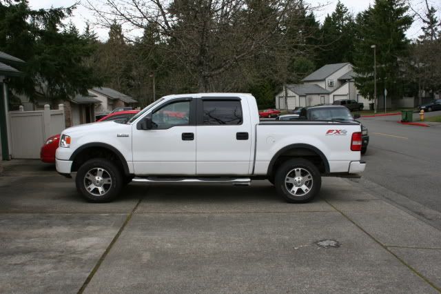

I've got the 2.5" AS installed right now
and on the floor in the garage is the 3" AS block (replaces the 2" OEM block).
in the pic below, you can see how my 2.5" sits dead level. Hopefully if I ever install the rear blocks, I'll be at a 1" rake again. My truck sits kinda butt heavy when I have a full tank of gas, and dead level when it's 1/2 tank or less
I used to like the whole exactly level look...but for some reason I want a little more factory rake back...that's why I bought those 3" blocks...almost 5 months ago
