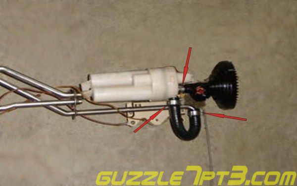

The in-tank mixer valve has much finer screen than what you found on the foot. The screen on the foot is just to keep leaves out of the fuel lines. It sounds like your screens are completely clogged up and you would not be the first one to have it happen. This is one of the reasons to do the in-tank Hutch mod.
The arrows are pointing at connections that have to be removed when doing the in-tank mod. The white plastic unit is what contains the screens that get clogged up.
