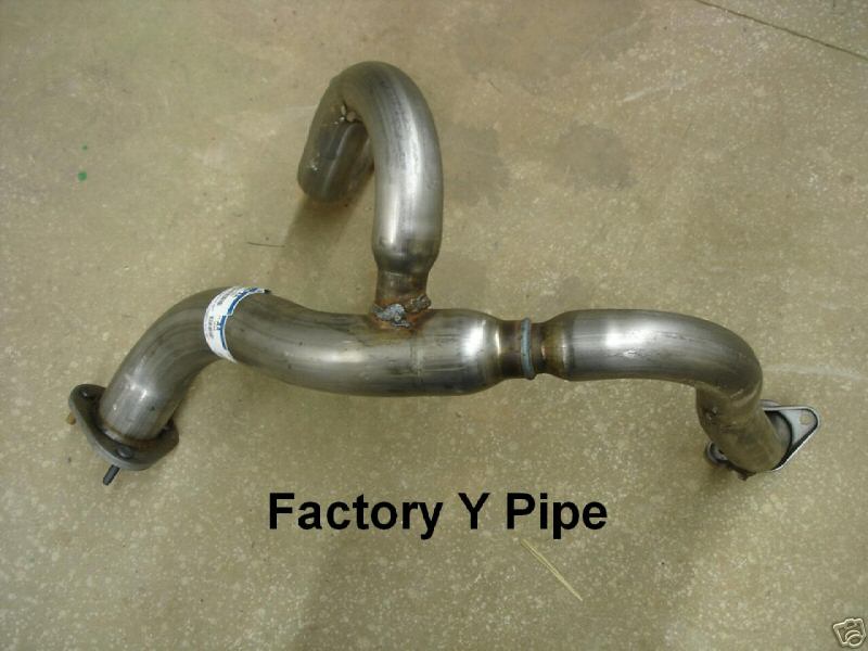

The 2000 still had the non ramshorn y-pipe unless it was replaced with the ramshorn y-pipe under a TSB due to flutter (I think this is the only reason why some 2000 have them and some don't). Mine still has the non-ramshorn y-pipe. You'll have to look at yours and see which one you have. It will make a difference if you decide to replace the y-pipe.
1999-2000 y-pipe (unless replaced):

2001+ y-pipe:
I got these images from a ebay seller called spd-performance.

The upper is the '99 "ramshorn".
The lower is 2000+ restrict-o-matic

Not all 2000's had the bottom one. Mine has the top one. In 2001 they all had the bottom one.

so is the top one ok? because thats what i have

The stock horns are okay, just not as free flowing as a y-pipe and imo minutely affect performance possibilities. If you decide to replace the horn with a y and do, make sure to reset the pcm by pulling the negative off the batt, turn headlights on to drain any residual charge in the line and wait at least 15 minutes before reconnecting so the puter can relearn the new air/exhaust flow. Unless of course you have a programmer then it's a push of a button to reset!
