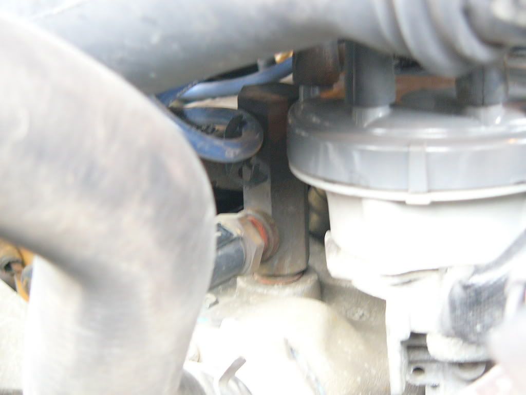

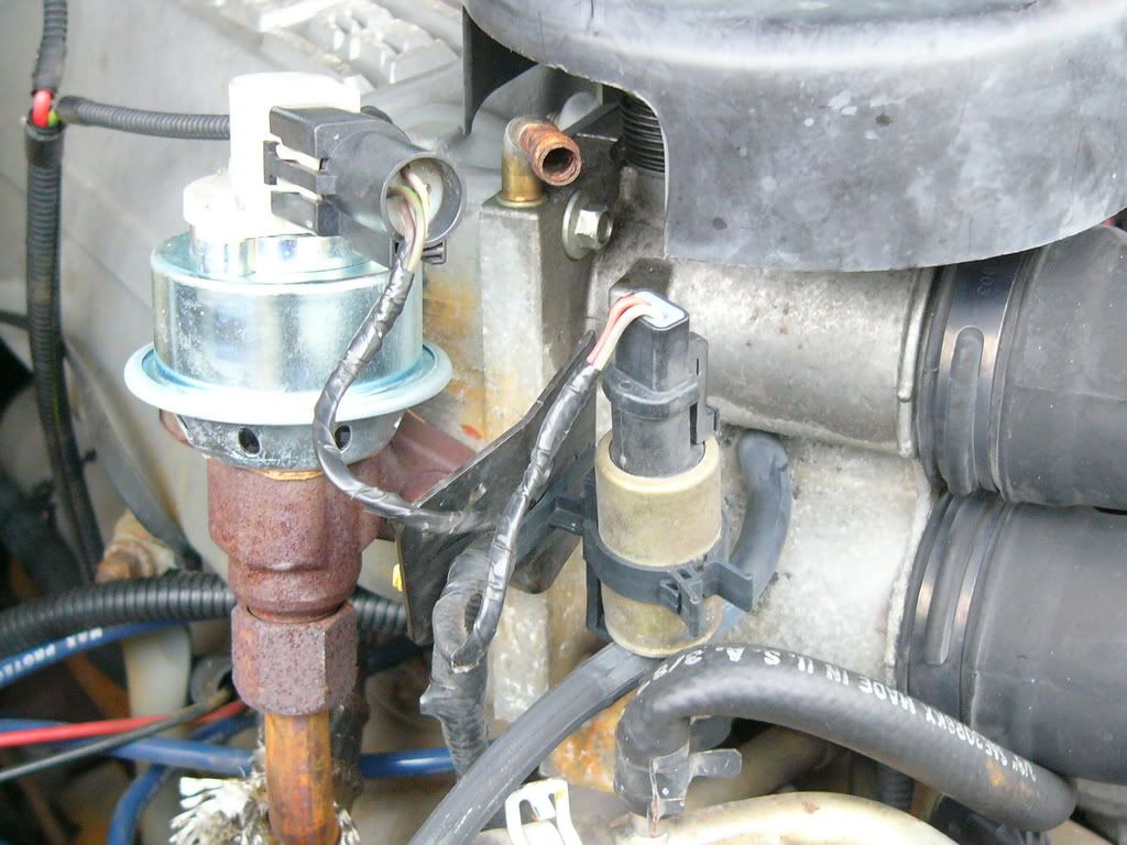

95 F-150 302. im having problems with the truck starting in the mornings. i got the battery checked, its good. changed fuel, no help. it has problems starting in the morning after that it starts everytime. i found this(below pic) not connected, look at another truck and the line comes from a heater line through the TB, out from the bottom to a sensor near/on the thermostat. the line on the top pic thats kind of kinked goes to the top elbow..what does it do..

The sensor in your bottom pic is your coolant temp sensor. The hole in the TB is where coolant runs through to warm up the air charge before it enters the engine. If your having problems w/ idle replace that sensor, i did and it smoothed my idle right out.

the idles goes up and down every once in a while.. but will not having that hose connected mess with the truck not starting? i dont think so since it just warms it up..

They've just got the throttle body coolant lines bypassed. That coolant running through the TB supposedly keeps it from icing up. I have mine disconnected as well. I removed the metal line that runs from the radiator and plugged it off at the radiator. That adapter where the coolant sensor is and where the other side of the TB line goes was bad and leaking on my truck. I ended up fabbing a new on w/o the TB line provision out of a brass nipple and fittings, couldn't find that fitting anywhere.
As always, I'd pull the IAC valve and check it out real good. Make sure the pintle moves freely. Make sure the ports are open as well. AIC valve may be sticking when it's cold.

where is the IAC valve? is it in one of the pics?

It's over on the other side of the TB
