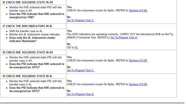

normally you click on the user name. a drop down menu will pop up and you will see the option to send a P.M.
you might have to have a certain # of posts first.
that is all there is to the t-case. 2 different wire harnesses.
can't find a exploded view of it for you...did find a symptom chart though

Thank you for that Tylus. I will check both of those connections and then go through the list.

best of luck. if it isn't the switches, the flowchart says to check the inst. cluster...that would suck if it's the culprit
