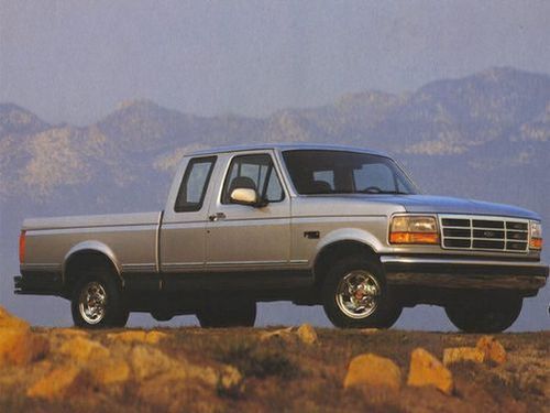

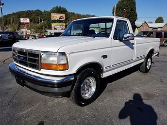

So when the running/ parking light are on (switch pulled one notch) small and larger orange bulbs in the orange cover should be on and also the white bulb in the small square next to the headlighs but headlights off. Right now my 93 f150 extcb 302 only the top corner white bulbs are on and only the small orange bulb in the orange cover is on. Shouldn’t both orange bulbs be on in the whole orange cover w headlights off. Jus double checking TY
What front of my truck looks like

Does the other bulb come on when pulled to 2nd notch ?

Or act as a turn-signal only? I'll try to remember to check the action on my '92 tomorrow and report back, but if they are supposed to come on with the others, then there could be any one of several problems.
But the most common is simply a burned out bulb.
And to 78 4x4, there are also some trucks with lights on top of the cab. They are known as "clearance lights", but could also be called running/parking lights as well, and most would know what you were talking about.

Sorry i jumped in! I was searching for light stuff and ended up here. I will be more carefull. What the guy said was correct. When parking lights or switch is pulled to first notch, all lights are illuminated except the headlights. I use the word illuminated bc the larger blinker bulbs in the orange lens are not on, but the smal bulbs in the corner of the orange lens which are on, are strong enough to light up the entire orange lens and thus it looks like the the big orange blinker lights are on but they care not. I had everything undone and kinda forgot what the lights are supposed to look light. Thought maybe i had crossed some wires. Now everything put back together, lights rewired and looking bright and evenly colored on both sides. Thank u all for ur advice!! And allowing this post.
