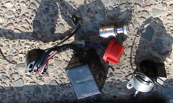

Not the best pic, but there are two of them right in the middle.
Some are just tie wrapped to the harness and some have a single hex head bolt that holds it underneath the dash right above the E Brake release.
It's real tight under there and getting the wiper switch out is where you scrape up your knuckles.
Take your old switch out, put the new one in and plug it in. It's that easy.

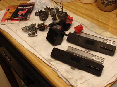

Uncle Stosh: You have two clocks also near the center of your picture. I've gotten two and neither of them were working properly. One would not accept the button depress to change the date/minutes, and the other simply didn't light up at all. Is that common for them to be non-functional?

Yep, it's a crap shoot with those clocks. They are notorious for NOT working.
I grab as many as I can and hope for the best. I cut a piece of the wiring harness out of another truck and use it along with a 12V battery to test them.
Here is another "Mo betta" pic of the wiper module and switch.
