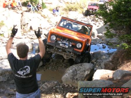

Crap I feel stupid I know quite a few broncos that are running 1 ton axles. Both old and new. When I read 60s I was thinking tires
I run with a guy who has 60s and a shaved soon to be 8" shaved EB. That thing goes...
as an example
