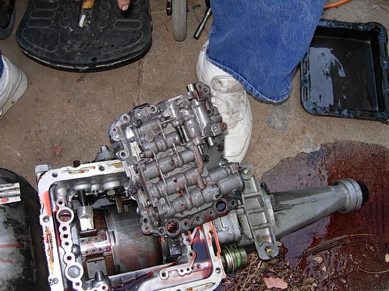

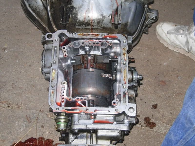

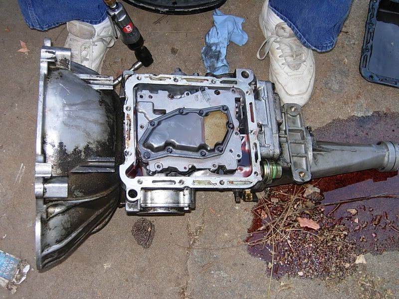

I opened the tranny up and took some pics of the inside of it. Does this help identify what year it is so I can get the right rebuild kit and shift kit?

Yes, but only because I know that early C-4 Cruisomatics had smooth shiny castings, and the later ones were rough. Like I said, take it to a good performance transmission guy and let him look at it. From what I see it looks like a 64-67 Cruisomatic C-4.

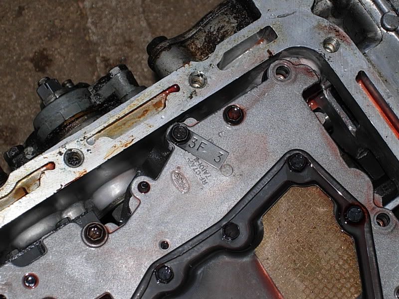

I took the valve body in to a tranny place and he glanced at it and said it was out of a '68. I asked how he could tell so easily and he pointed to an itty bitty number on there. the first two digits were C8 followed by several others. He said that Ford did C for 60's, B for 50's, D for 70's, etc. Then the 8 following it being the exact year, so it was 68. Sounded good to me, so I bought the rebuild kit, shift kit, and front pump since I was told it was bad. Man the stuff adds up quick. I'll take it to a guy that works at a Ford dealership tomorrow that said he'd do it as a side job for me. So that's out of the way.
