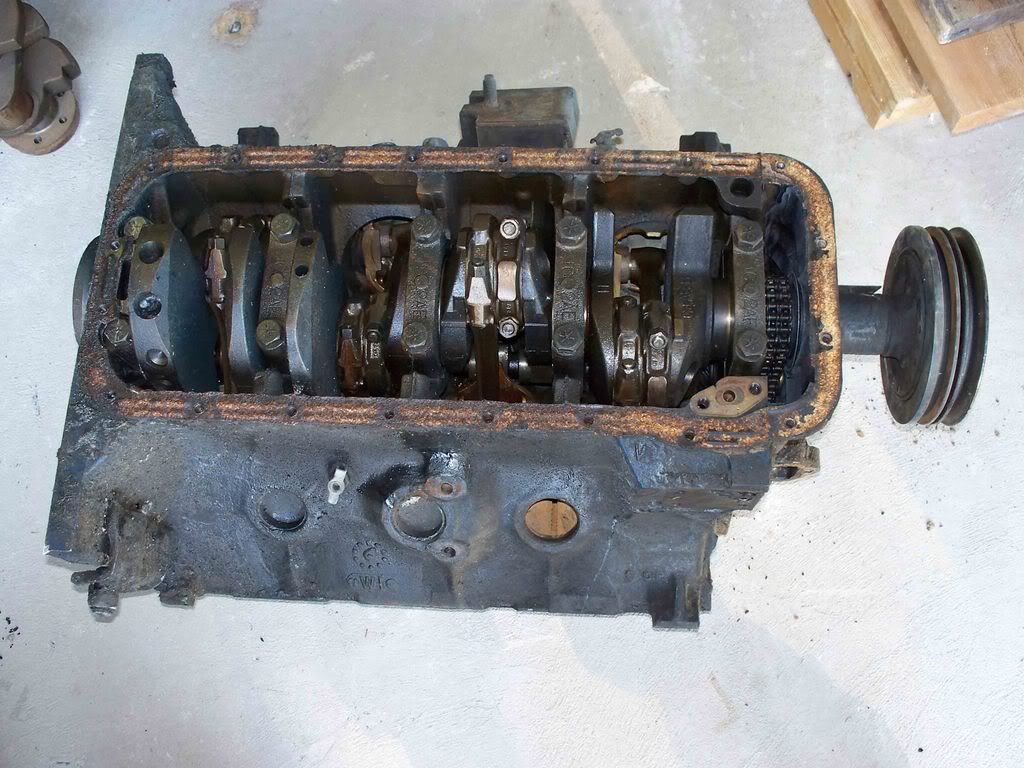

The date code for the block is between the oil filter adapter and oil pan. It has a number, letter, and number. The first number is the year, letter is the month (I think it was the letter "I" that was omitted from the designators), next number is the day of the month.
1964/65 was a year break for blocks. 1964 and earlier had only two holes for the engine mounts. 1965 and later have four holes for the engine mounts. The block I took from a 1965 Thunderbird has a "C5" casting number and four holes for mounts.
Here is an example of the 1964 block Glenn told you about:

Cool pic there Mike!!
Scottie, note Mike's info on the block date code location. The heads date codes are between the center 2 valve springs. Post them and we'll decode em. The 4D1 on the intake is the date code of 64/April/1st....yes April Fools Day...LOL.

Ok just went out and looked, block also reads 4D1 and the left side head reads 4C23. I assume both heads would be the same? It also only has 2 motor mount holes. I will assume a true 64 motor then?

Block is the same April 1st date then. Left head is 4C23 64/March/23rd and the other may be the same or earlier/later possibly by a few days or a week. Pretty common timeframes and yes it's a 64 engine. 4 bolt block mount bosses started in 65 as Mike stated above.
