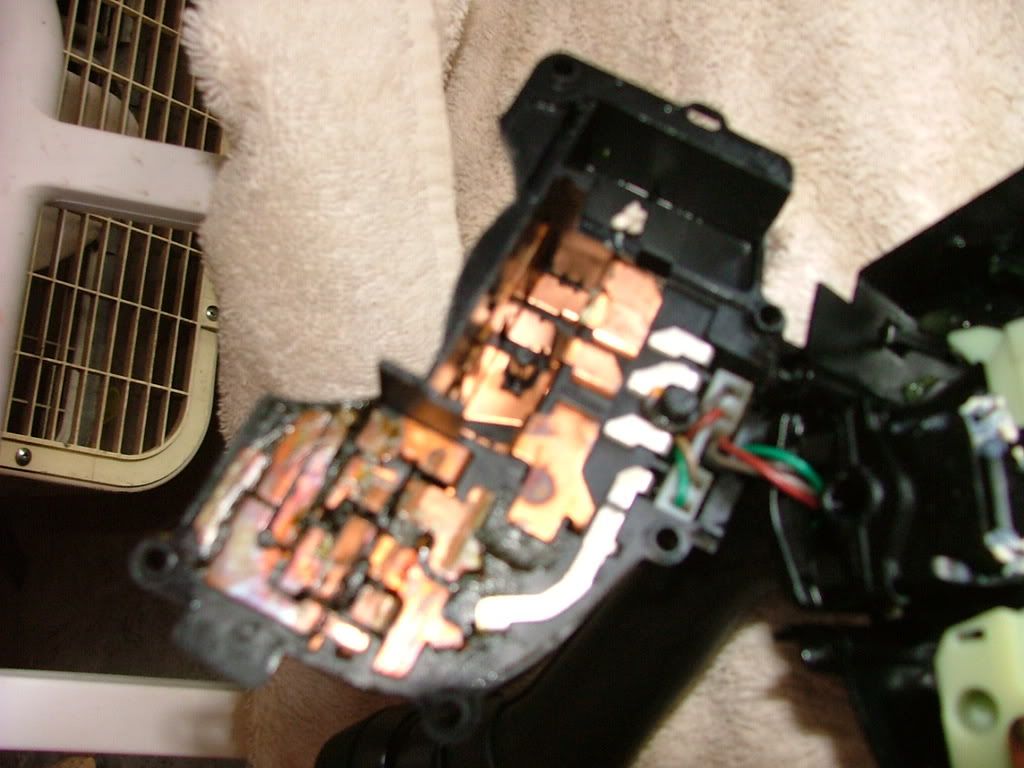

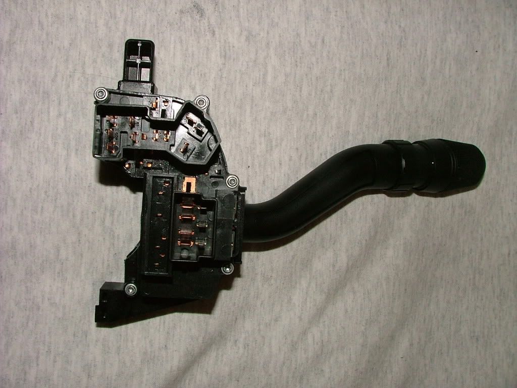

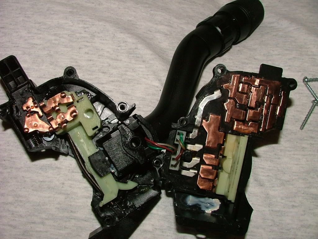

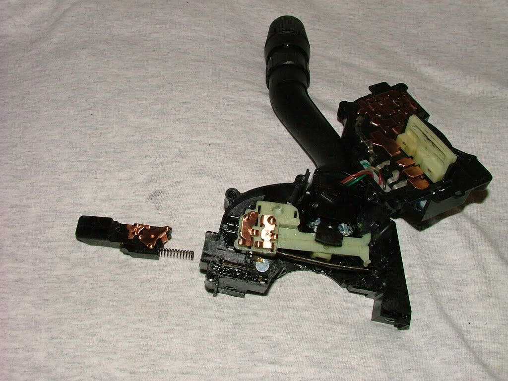

I did take pictures as I disassembled the M-F switch, something I learned from cleaning guns and fishing reels....take pix or video as you work
I've never posted pics before, but will give it a try. These pics aren't the best ... I couldn't quite figure out the Macro mode on the camera.
I will try to take a few pics of the demon multi-switch now that it is cleaned up too.
http://i237.photobucket.com/albums/f...-switch020.jpg
http://i237.photobucket.com/albums/f...-switch019.jpg
http://i237.photobucket.com/albums/f...-switch018.jpg
http://i237.photobucket.com/albums/f...-switch017.jpg
I hope this helps.

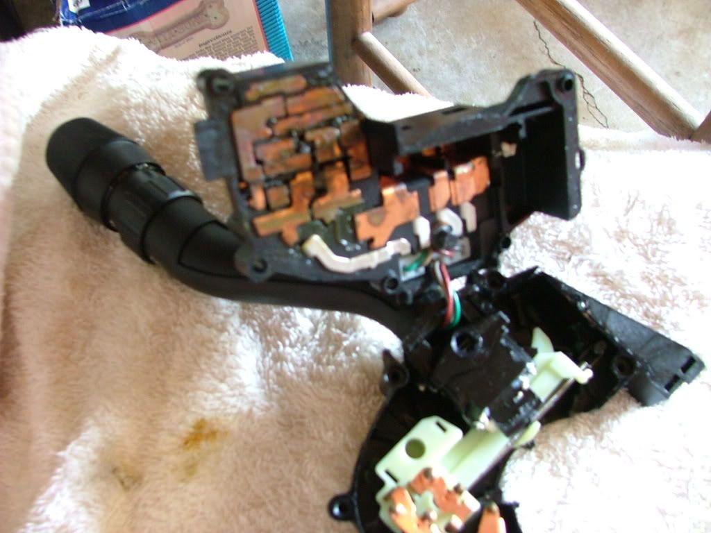

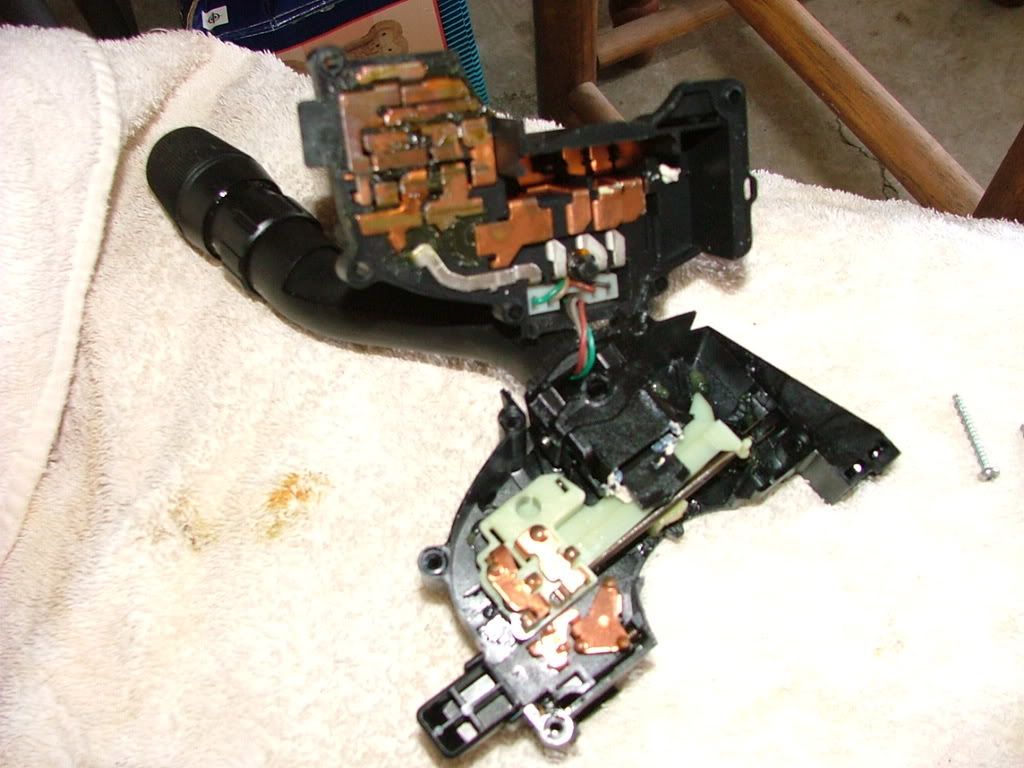

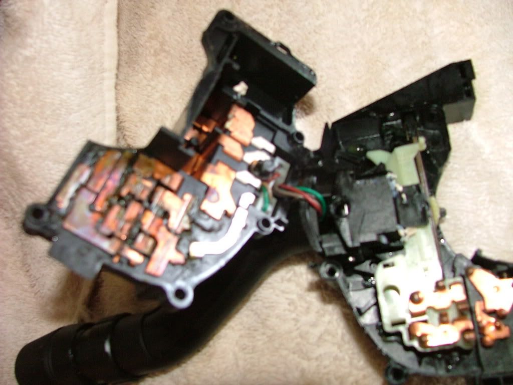

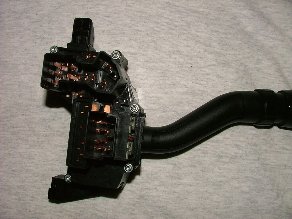

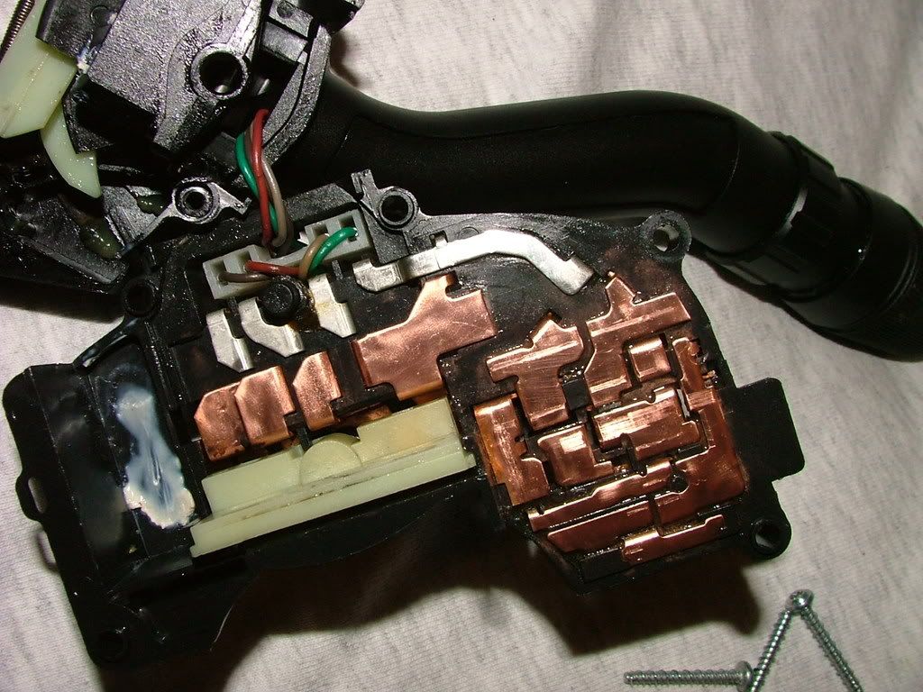

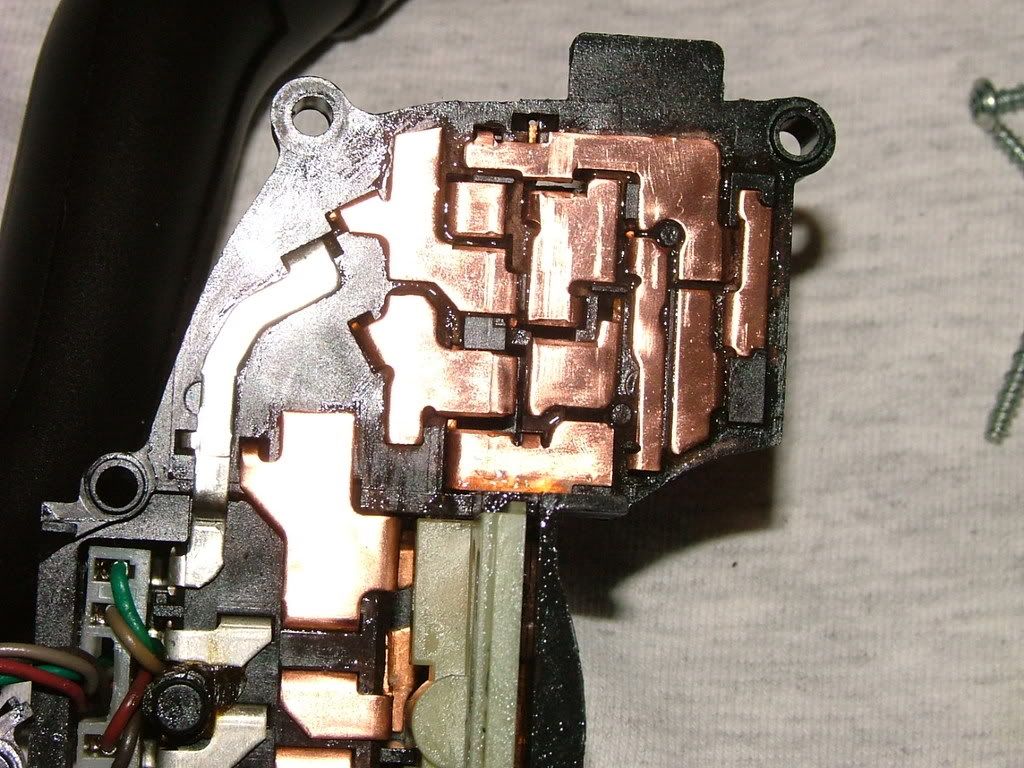

These pix are after I cleaned the contacts inside the multi-function switch. I still would try and clean it up and re-install it before I pay $100 for a new one.
You really can remove this in minutes once you've done it before. Be careful when undoing the wires connected to the back of the switch, the grey connectors are a litlle tricky to unsnap and it would be easy to break one.
http://i237.photobucket.com/albums/f.../multi2012.jpg
http://i237.photobucket.com/albums/f.../multi2010.jpg
http://i237.photobucket.com/albums/f.../multi2008.jpg
http://i237.photobucket.com/albums/f.../multi2007.jpg
http://i237.photobucket.com/albums/f.../multi2006.jpg
http://i237.photobucket.com/albums/f.../multi2005.jpg
http://i237.photobucket.com/albums/f.../multi2004.jpg
http://i237.photobucket.com/albums/f.../multi2003.jpg

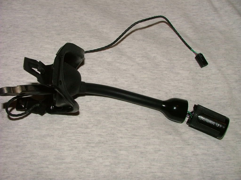

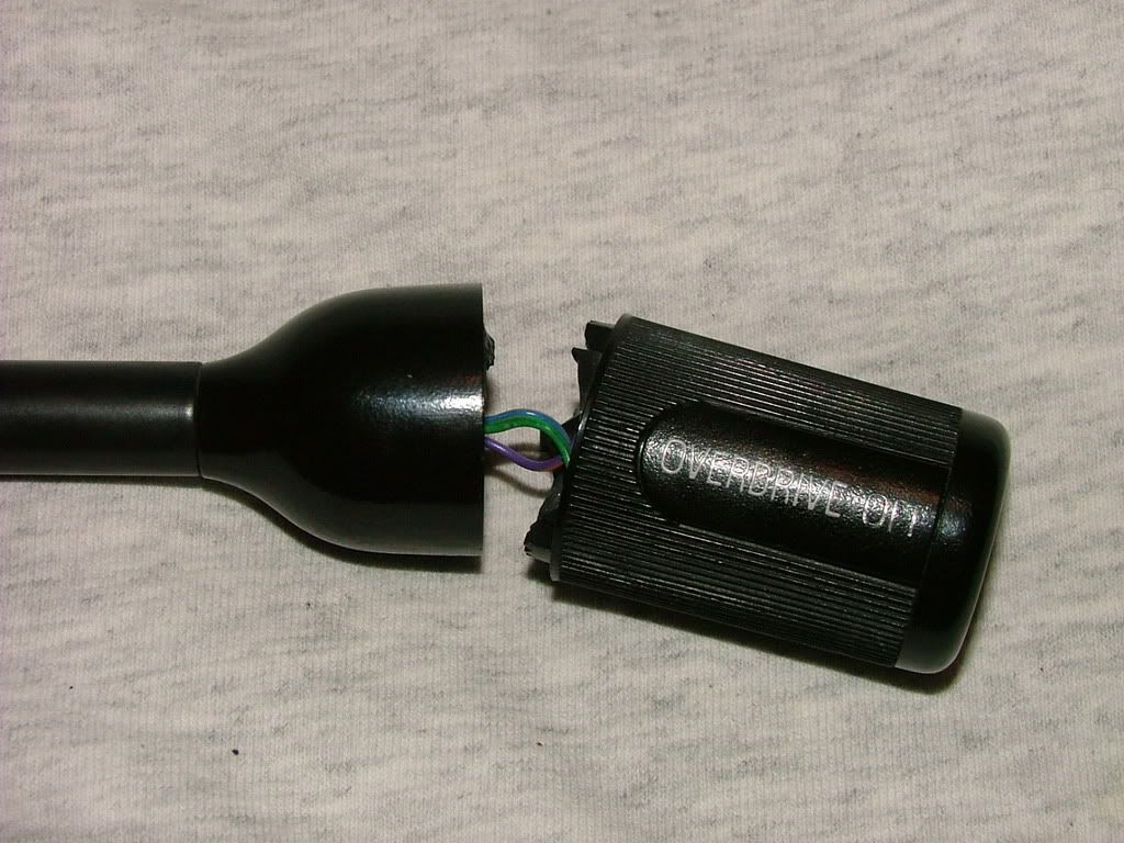

I took a pic of the gearshift lever I snapped too.

Very nice, thanks for posting. I sometimes find it interesting to look inside broken parts just to see where the weak point was. In the case of this switch, it was interesting to see the different wear patterns on different contacts.
