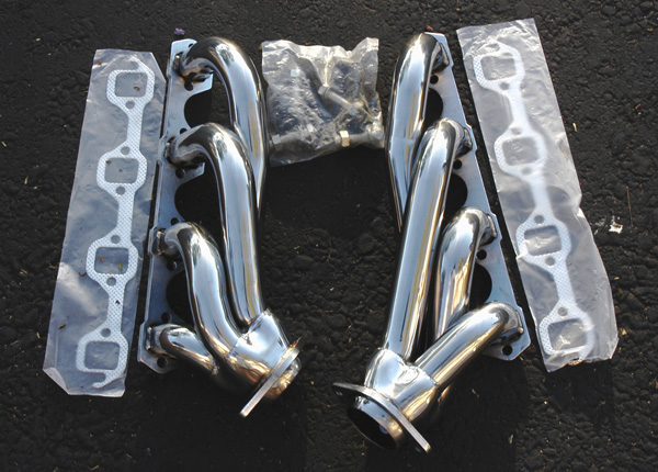

If he had the y pipe under it, it prob didnt fit when he put the headers on. Are they mustang style shorties? If so you will have to mod the y pipe to fit, if there truck style it should just bolt up. The way to tell is if the collectors are really close to the firewall. The truck shorties point down. Let me try to find some pics.
Mustang Style
Truck Style

that was honestly my first two thoughts that you guys mentioned. one being the fact that my 250 had the manual and this ones got the aod. but we did a sise by side comparison between the wrecked y and the good one and they look identical right downt to seconed cat cut off in the same spot. but my big thought was they were mustang style headers cause they do point at more of an angle to the firewall. which with what youve said they probably are. i was hoping to drive this truck out of is yard. but i dont think it will happen. i am gonna have it towed here, and then yank the the headers and confirm they are wrong and then either use my iold manifolds or buy a complete header to tip exhaust for it so its done right, thank very much for the info. this is only my seconed ford truck and first with mods like headers. im used to long long tube headers on gm g body cars so y pipes and and shorties are all mind boggling to me right now.

Originally Posted by 95F350XL
... The way to tell is if the collectors are really close to the firewall. The truck shorties point down. Let me try to find some pics.
First thanks for the pics, I've often wondered the differences & never had a chance to compare.
But isn't the second set mustang shorties too?

The 2nd set is supposed to be the 5.0L truck headers, at least that was the pic that I got, the 3rd set is a pic of the 5.8L ones. So who knows.
