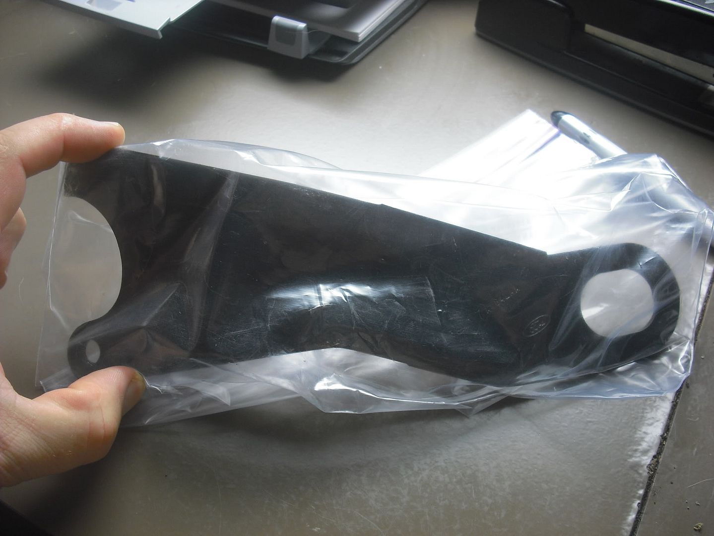

I think that a part that fell off my truck yesterday and onto my driveway is the same part as described in the original post!! Except mine starts with an one instead of an "I". The number is 1L3E 17A084_AA and has "Ford" stamped on it in a circle. My truck is a 2002 F150, 4.2.
Here is a pic.
Can anyone ID this part from the picture and number stamped on it? Mine was resting on the steering rod against the firewall and making an awful rattling noise until I traced the rattle to the steering rod, and opened up the hood, saw the part on the rod, thought to myself what-the-heck-is-that, and touched it to see if it was rattling, and it fell to the driveway. It must have come from elsewhere under the hood but what are the odds of it just sitting there on that rod?
BTW the flat part of it looks 75% sheared off, smooth, with 25% rough edge?

hey i gots an answer for you! turns out his forums page answers your issue!
http://www.mustangboards.com/parts-d...-did-come.html
its a bracket for transport, the dealerships are supposed to remove it before sale. LMAO

thats an engine lift bracket that is normally bolted to the rear of the head.
