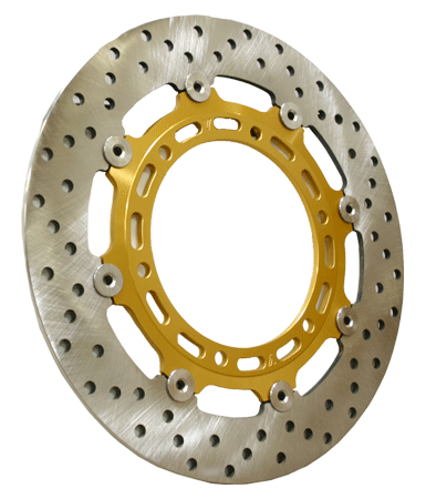

Drilling rotors is a move typical of applications where weight is an issue ie. motorcycles, race cars, drag cars. these types of applications also use rotors that are NOT vertically cooled like ours.
Motorcycle rotor
Our rotors as you can see on your spare set, has two metal discs that are seperated by veins (layman's terms). When the wheel turns these acts as fans/turbines and pull air through them. This cools the rotors.
Also because of the design, I find it difficult to believe that the rotor can actually come out of round. If it were one solid piece then I could see it. But our rotors are not. In fact, motorcycle rotors are typically floating rotors, like in the picture above. Those round things between the gold part and the rotor allow the rotor to float and not be solidly attached the carrier (gold part). This is to compensate for when it DOES come out of round.
