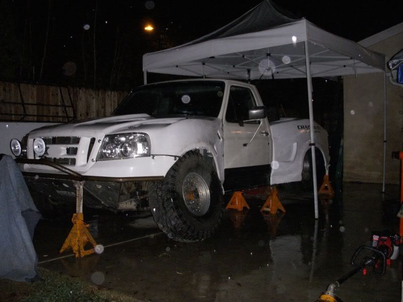

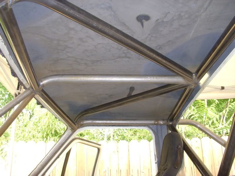

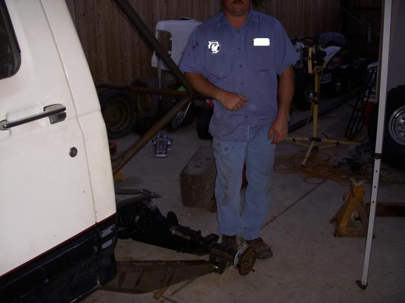

the truck
Old Jun 4, 2008 | 06:55 PM
chaunbot's Avatar
chaunbot
Joined: Jan 2008
Posts: 9
Well the front has 24" of travel and the rear has about 34". For the most part the truck is set. I have the shocks. 35" tires. Still want to build a 351 I aslo want to go to pismo so a 500hp motor will throw a fat roost with my padlde tires . I'm not worried about somg i ot a hookup at a smog check only
