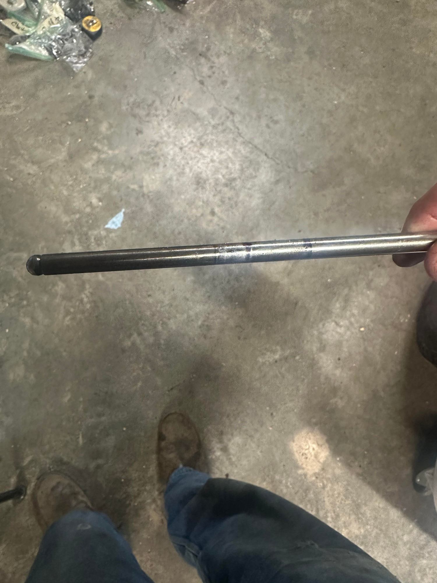

So I have the head off my old engine and the new engine. I decided to check the stroke between the two blocks. So at the bottom of the stroke I put the darker end of the push rod on top of the cylinder and drew a line with the sharpie. The first line is from the newer engine, and the longer line is from my old engine. I think I'm just going to get the new engine going so I can get my daily back on the road. When I get my baja bug up and running, I think I'm going to find out my issues with my old block, and try and build it up into something a little more fun. Does anyone have any suggestions for a rear end that would get me going a little more than 60mph? My truck is a '66 F100.
