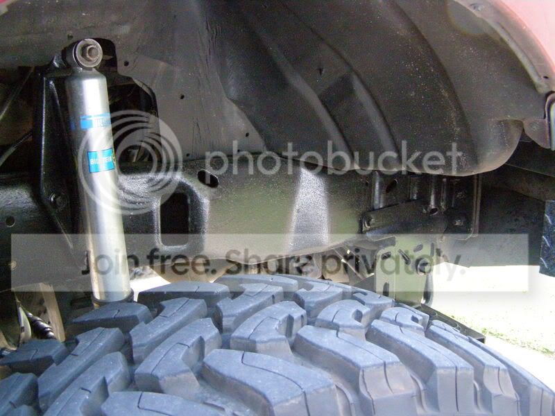

That pic was driving me crazy so I went outside to look at mine and I took a pic. The holes are definitely from something that was aftermarket. Barry could right about a front receiver hitch.
Here's mine:

Thats a Western Unimount plow set of holes. I would bet a dollar or two. I have the same set (only with the mount attached to them .

There's a good chance Barry has never had the bad luck to see a snow plow (LOL) but those holes are pretty heavy duty looking for a front hitch. I would bet on a plow also.
Here's mine:
Oh yeah, and DAMN Scott!!! Do you get an echo in that wheel well??????
That looks awesome!!

One thing to note is the blocker beam is still there(and doesnt look to be recently installed). My Boss plow required its removal. Dont know about other brands, but would assume it would be in any plows way.
