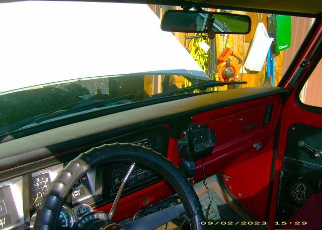

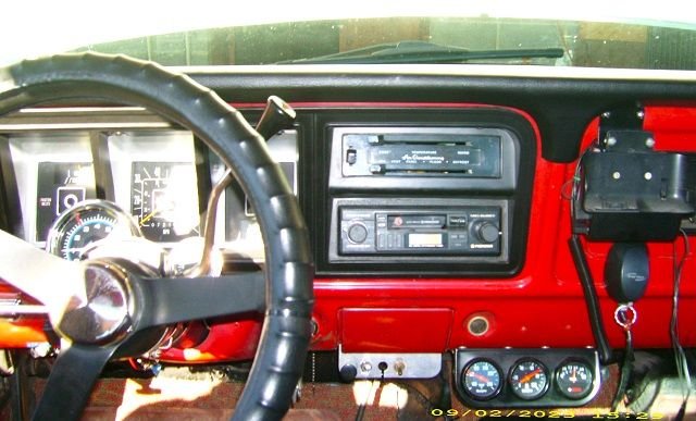

I bought a molded from a plasticized rubber like stuff, it just goes over the factory pad. It's got the grain look, fits so well It just softly snaps into place, that I did not even consider using the silicone that came with it. It's black, but my cracked (5 places) stock one is red, but it's totally hidden now. I already had a black carpet like cover I use too. I got mine from Auto Krafters just up the road a short spell.
Above is without the carpet top cover, below is with it.
I was looking for one the other night for a fellow, not sure they have them now but others do, like LMC or Dennis Carpenter.
