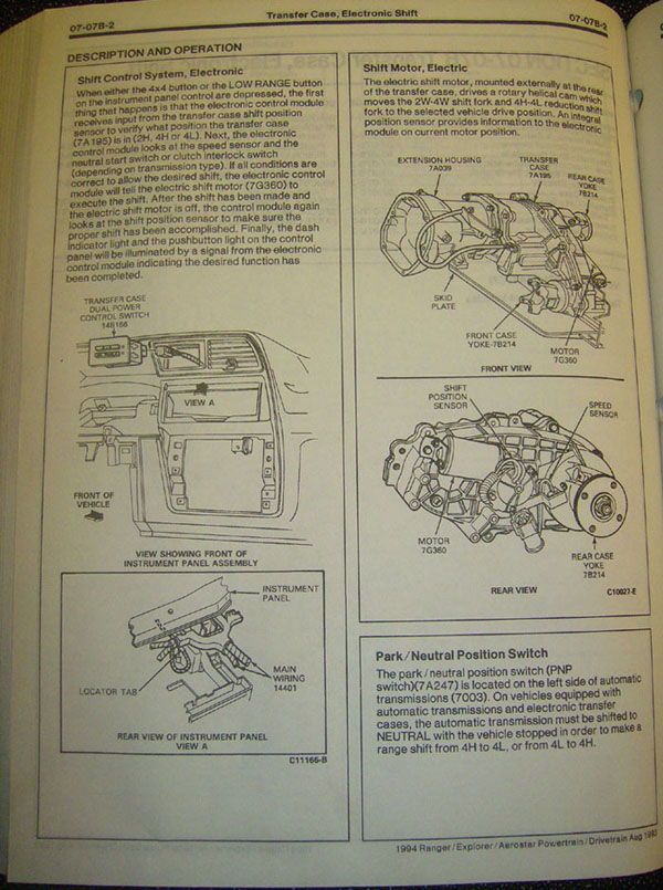

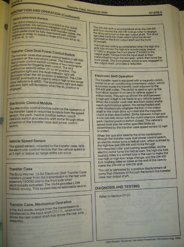

Keep in mind, the shift motor only activates 4H to 4L, 2H to 4H activates the electromagnetic clutch in the T/C.
Check for 12VDC on the single brown wire the enters the T/C when the switch is in the 4H position.
Are you sure about this? My 1994 shop manual says the following:
"The electric shift motor, mounted externally at the rear of the transfer case, drives a rotary helical cam which moves the 2W-4W shift fork and 4H-4L reduction shift fork to the selected vehicle drive position. An integral position sensor provides information to the electronic module on current motor position"
And regarding the magnetic clutch...
"... The clutch is used to spin up the front drive system from zero to vehicle speed in milliseconds. This spin-up allows the shift between 2-high and 4-high to be made at any vehicle speed...."
So I think the motor still comes into play for all shifts (at least on the gen 1's) and the electromagnetic clutch helps with the shift on the fly part of it..

What aquanaut said applies to the 2nd gen Explorers with the control trac t-case. On our 1st gen Explorers, the shift motor is responsible for each shift on the t-case.
Not correct, we have a 92 (first Gen)which works the way I explained, the 97 (second Gen) has the addition of hale sensors to activate the shift to 4H in control track mode.
How do you explain these pages from my '94 shop manual? These pages clearly state that the motor moves BOTH the 2W-4W shift fork and the 4H-4L reduction shift fork.
