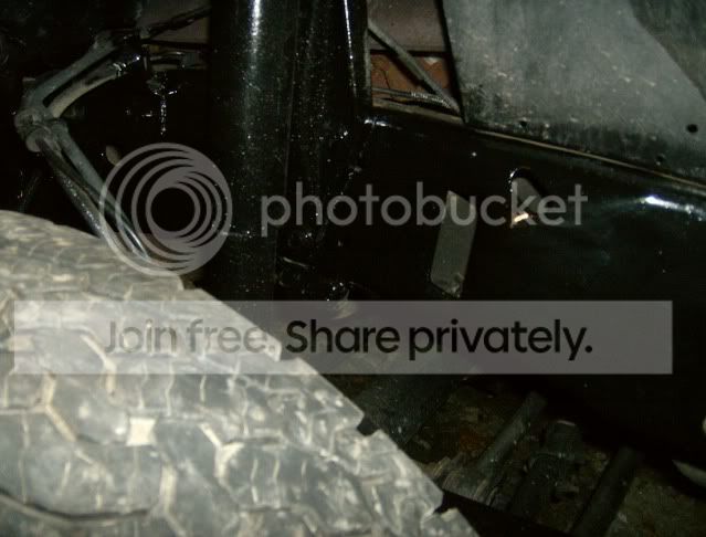

here is the undercarriage of my superduty with por-15 brushed on

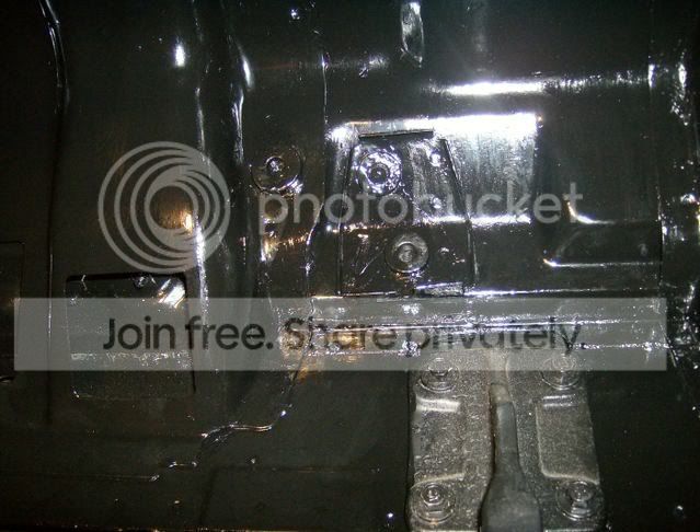

and here is the frame with por-15 brushed on
