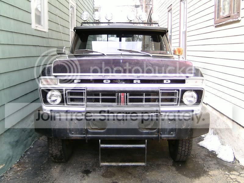

That's one heck of a bumper rsalter. I like the bug guard too.

That stuff was on my parts truck, I just put them on her
the other bug shield that was on it was busted and it hides some surface rust for now
I think I'm going to write something on it?
someone suggested "3VOM", MOVE backwards, or "if you can read this flip me over" but write it upside down
