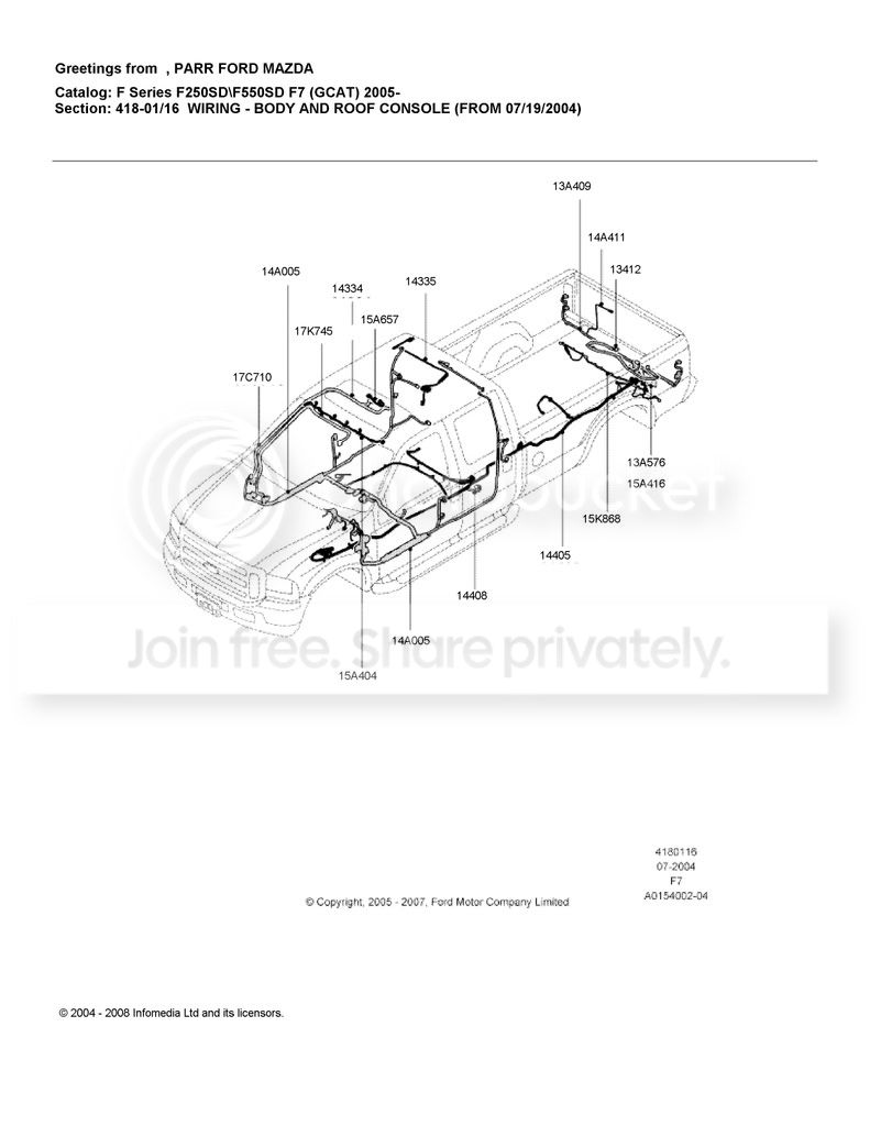

Ok,i Know Its Been Asked Before,but I Need Help, Just Purchased Factory Lights And Harness Asm From Ebay.where Does The Harness Plug In At ? Looked All Under Pass Side Can Not Locate Plug. I Do Not Have Any Overhead Consoles Or Etc. Any Help Would Be Great. Truck Was Built In March Of 07 If That Makes A Differance.

How long is the harness? If it's just a foot or so, check the a-pillars and under the head liner. If it's long, then I would expect under the steering wheel or behind the glove box, the wire run down the A-pillar.

According To Dealer, It Should Plug Into Harness Down On Pass Side Kick Panel,i Checked There Is No Spot For It To Plug Into. I Was Told That That If The Truck Was Not Ordered With Them You Can't Add Them , I Find That Hard To Believe. Also It's A Long Harness And Looking Back At Previous Threads, And Pics, It Goes On Pass Side,hopefully Someone Who Put One In Would Get Back To Me. Thanks For Trying.

Did you remove the passenger side floor strip and then pull off the right passenger side kick panel? That is where the plug was located on my 2005 and everyone who has posted here with about '03 and newer (even some older) have had the plug there - just been a matter of having the right plug on the end of the harness - my plug fit was correct and went right in when I installed them. Seems odd to me they would stop putting this plug in the '08s unless it was ordered with them.

it's there, there is allot of question to ask to get right loom, but nothing about with or without roof marker lights. So it is there.

Ok!!! Found It!!! The Missing Plug Under The Dash For The Factory Lights On 07-08 S/d Is On Drivers Side Just Above Parking Brake Assm. All The Directions Everyone Is Giving Say It's On The Pass Side, Makes More Sense To Be On Left So Its Closer To Headlamp Switch . Now I can Finish My Install.I Hope. Thanks To All Who Are Triying T Help. Just Remember Guys, 07-08 Up Factory Plug Is On The Left Side.

there is a separate jumper loom 14335 that goes to the DVD player.

There are two different connectors due to the overhead console.
If yours doesnt fit the connector and you dont want to cut anything you can remove the pins from the connector on the light harness and plug in them into the harness mounted behind the pass side kick panel. Then use some electrical tape to hold them in. Colors should be Black for Ground and Brown for Power
