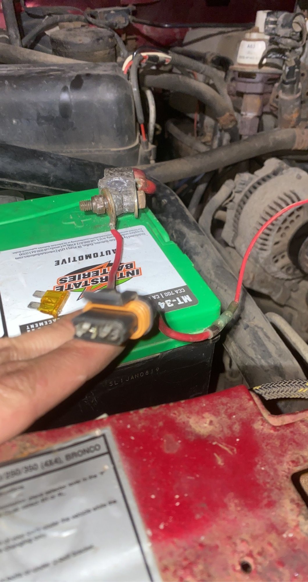

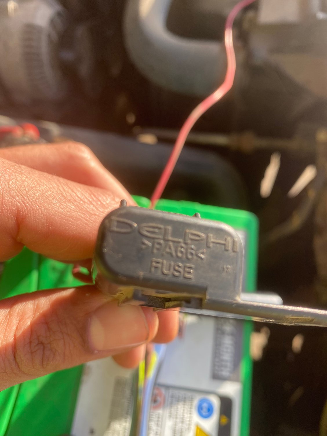

Your truck doesn't have a headlight relay. The headlight power runs from the headlight switch to the steering column dimmer, and then out to the headlights low and high beam. First check the fuse you are pulling to see what it is labeled. Make sure it really is a headlight fuse. Most of the older trucks didn't have a main fuse for the headlights, you are in the years where they may have started but I am not sure. What I would do then is pull the headlight switch plug and then put the fuse back in and see if the headlights are on or off.
here is a picture of the fuse it’s right off the battery terminal and appear to run all the way eventually into the headlight switch
That is a red flag right there. That is not stock, someone has wired that in. If you want to keep going with that, pull the plug on the headlight switch and then plug the fuse back in. If the headlights are now off, there is something wrong with the switch.
do I have to disassemble the dash to get to the switch to be able to disconnect it? Or should there be a fuse that controls it?
You usually have to take the dash apart some to get it out. I was thinking more about it, there is a chance someone installed a relay kit in your truck. The aftermarket makes them. It makes the lights brighter by feeding them directly from the battery through a relay to the lights, instead of going all the way into the factory headlight switch and then out to the lights. But the headlight switch and dimmer switch still trigger the relays, but the current to run the lights comes directly from the battery.
You may need to investigate that wire with the fuse in it that you had in your hand a little more. Follow it along and see if you run into some small black boxes that would be the relays. And then they would plug into the headlight wiring. If you do have a relay kit installed, there is a chance one of the relays has welded itself shut making the lights stay on.
