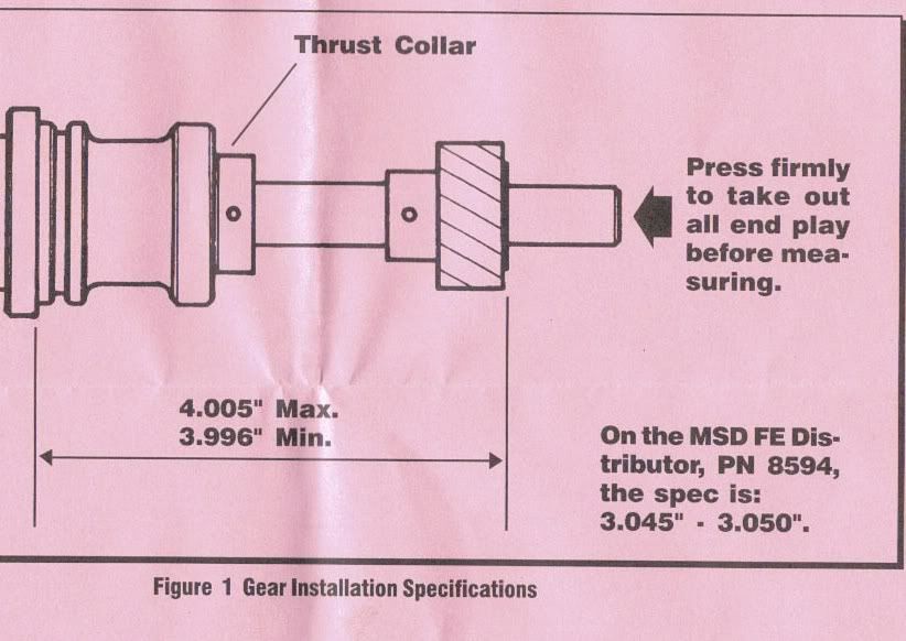

I would check the installed height of the gear. If the gear is binding against the block it will break the pin. Here are the specs for a MSD bronze gear. They should be the same for a stock one.

hey thanks guys scooter and green- those were the things i was looking for was hoping it wasnt anything to do with the block. i run 10w40 year-round and im pretty sure the pump is stock, but you never know what the p.o. might have done to it. i was told the motor was rebuilt, but the carb is still factory original so im doubting it. doesnt matter one way or the other- it seemed to run fine before the distributor went. im thinking about throwing an edelbrock carb on it because the throttle plate on the factory carb is shot. ill try the hardened pin and check the installed height after pin replacement, and update you all on how it worked out.
