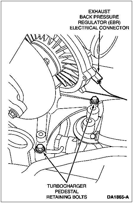

disconnect the 2 wire connector under the inlet of the turbo

Disconnect this, Pic Courtesy of Cuda_Jim

So do you need to wire the valve open also? Or do you just need to disconnect the plug?

just disconnect it.. thats it!

lossscause, No need to wire it open unless it's closing on it's own after the connector has been unplugged.
Is it possible for the valve to do this?
