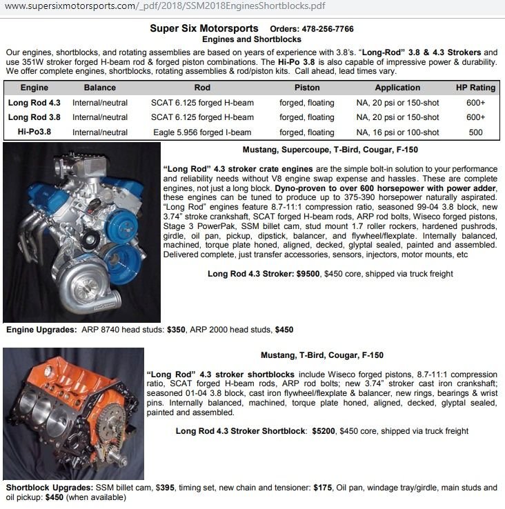

If it were possible, someone would have done it by now. There would have been a surge of others doing it. There would have been postings on every F-150 forum. And if it were profitable to sell the conversions and parts kits, Super Six Motorsports would offer it. If you are set on trying to fix up your old 4.2L, then turn to Super Six Motorsports. If it works, they have it. If you feel that it is worth it, then allocate your budget accordingly.

For anyone out there who still has a 4.2L V6, and you're considering keeping it.....as opposed to just letting go of it and buying a new car......
