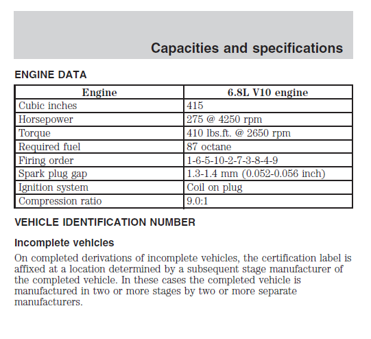

I own a 1996 Ford v10. It is installed in a 36 ft motor home of the same year.
What is the hp and familiar problems with it?
THE DOC
Old Feb 3, 2025 | 10:48 PM
CathedralCub's Avatar
CathedralCub
FTE Community Team
Joined: Jan 2019
Posts: 10,563
Likes: 1,464
THE DOC
Yours should be the same as my 1999 F-53, and from page 87 of my F-53's owner's manual:
Old Feb 3, 2025 | 11:00 PM
CathedralCub
FTE Community Team
Joined: Jan 2019
Posts: 10,563
Likes: 1,464
Forgot to answer the other question: They hold up pretty well. Mine's got almost 100,000 miles of weighing ~17,000 pounds completely empty under it's belt and still fires up and runs happily every time! They do have problems from time to time like any engine, but they don't really have any really widespread terrible chronic issues except maybe exhaust manifold bolts snapping.
